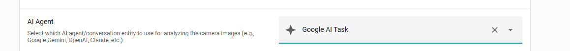

  • Updated to use ai_task.generate_data >> Now requires AI Agent Selection this allows you to choose which Gen AI agent you want to use.

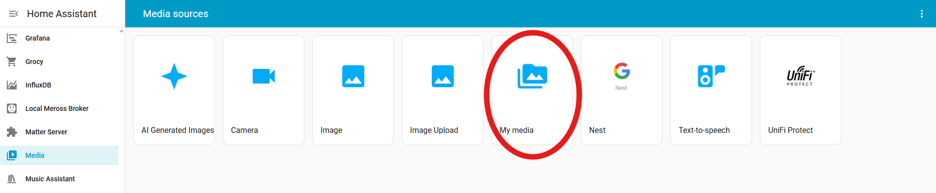

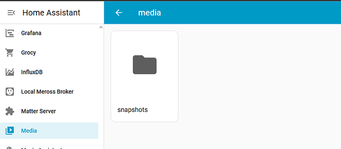

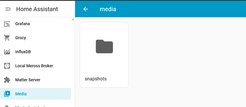

  • Uses media reference allowing you to browse snapshots in media tab of home assistant. This also improves security as the www/snapshots folder is public where as /media/snapshots is not.
  • Using Actionable notification to now open the image in home assistant, this is to support the new media directory which is private and as a result both improves security and allows you to view the full image snapshot, rather than a small notification sized image. Notification will not look like below now, instead of the image you will get a link to open the image.
