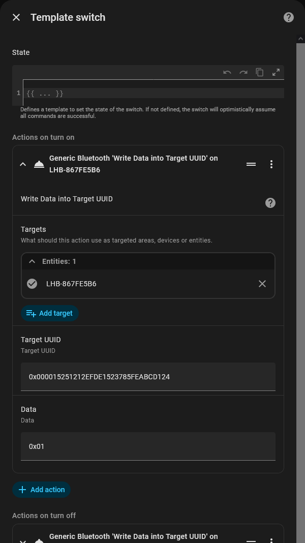

Hi Billy, yes I did the same as you then said “Where’s the switch to turn it on/off?”
So I made it and it works great:
Settings->Devices&services->Helpers->Create Helper->Template->Switch
Turn On, Add Action->…other actions->Generic Bluetooth (yes, now it’s there!)
…and the rest is easy, +Choose device and fill in Characteristic’s UUID and data, in my case On=1, Off=0.

Hiya!
I’m trying to setup some BLE devices and I’m getting error about invalid UUID/hex formats.
I’ve tried with the “-” and without, I’ve added “0x” in front and without…
Error from above settings:
Error when removing the “0x”:
Error when using the “-” in the UUID:
Error when using the “-” and “0x”:
I’m really lost as to how to input the UUID and Data in these fields…
Thanks!
