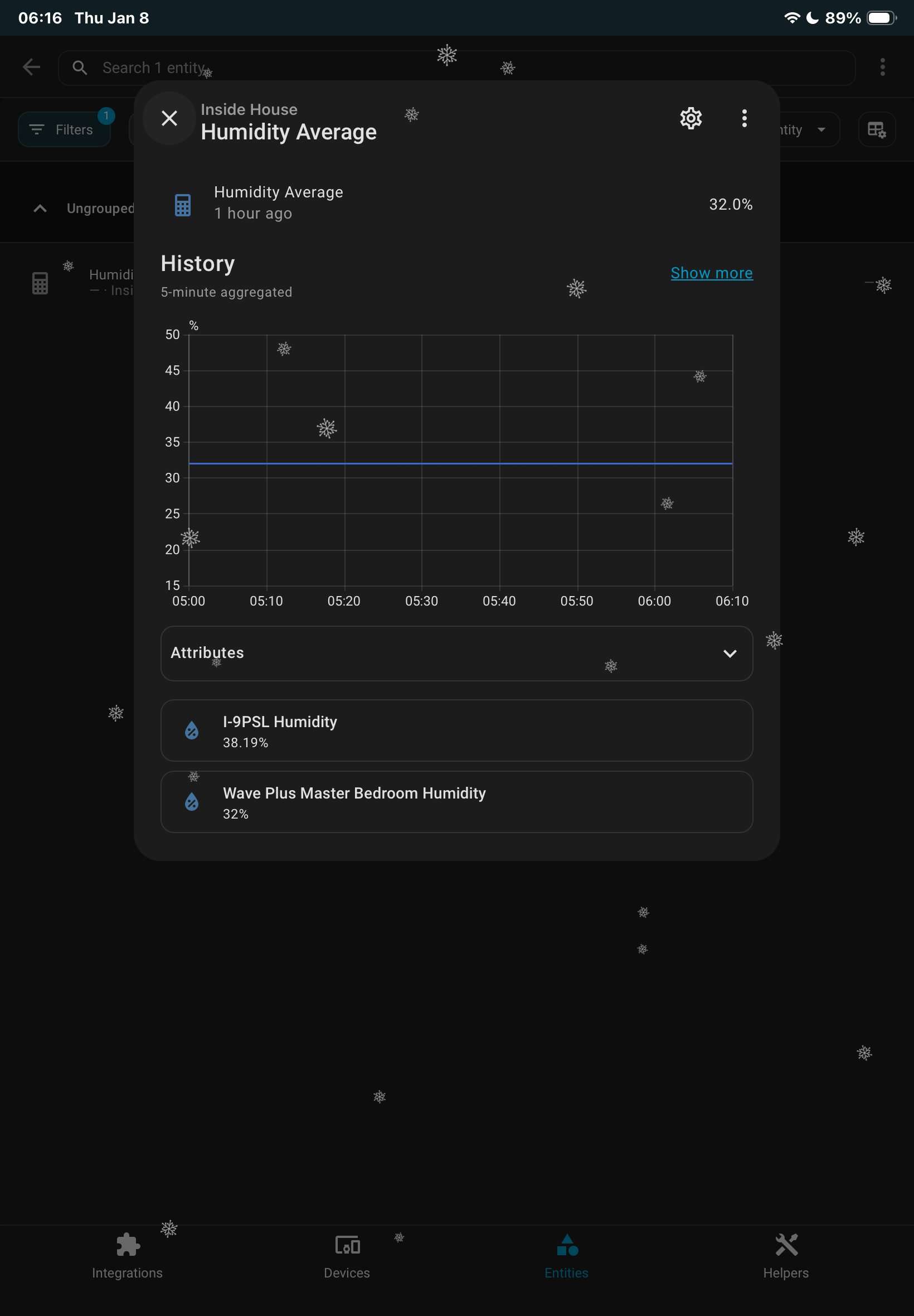

  1. created a helper that’s called “sensor.two_humidity_sensors” That works and I can see an average number.

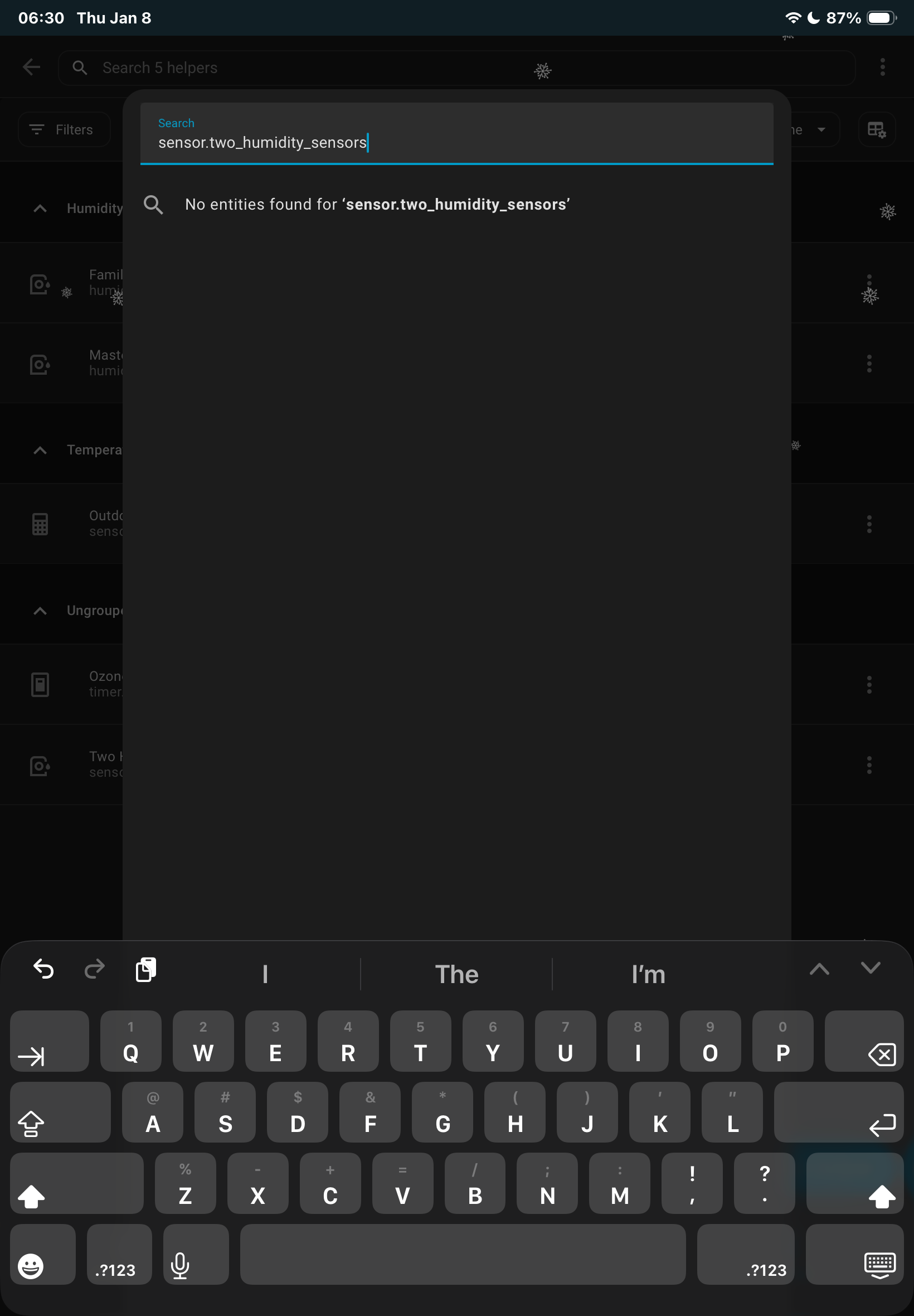

  1. When I try to create a generic Hygrostat I can’t see that sensor to use it.
Copied sensor name and can’t find it in a search.

Does your avg sensor have
device_class: humidity
unit_of_measurement: “%”
configured?

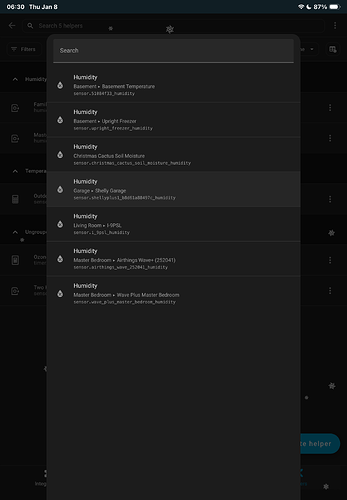

When I search for that one I get
this is where I’m getting stuck or confused.
When I look at what’s available it’s not in there.
Make a template sensor for average with required parameters.
