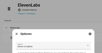

Thank you very much! I’m glad to hear I’m not alone. I found a nice solution, maybe it’s interesting for you, too.
I’m using Elevenlabs TTS and I switched the model to Eleven v3 (alpha). My impression is, that it handles numbers much better.
