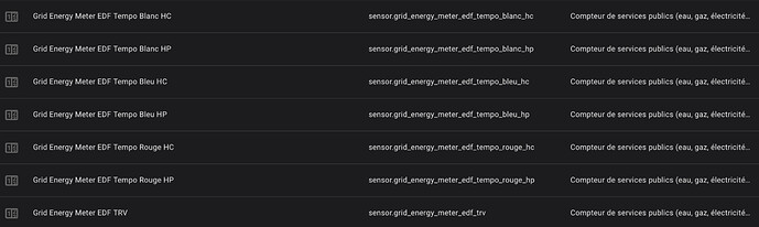

Bonjour, j’ai tanté de suivre ton poste mais dès le départ mes “entrée” de type compteur ne ressortent pas comme les tiennes.
En effet j’ai deux “entrées”

@mathieucarbou when you create the counters, which entry sensor do you use for each one ?

So I configured the script, automation and all the helpers using the tempo.yaml file from @mathieucarbou. All these helpers/entities have the sensor “source: sensor.grid_energy” but I don’t see how to configure this source because on the TIC of the linky I have the HPHC and HPHC. If anyone has an idea how to create this sensor which would allow switching

sensor.grid_* are my Shelly EM sensors
