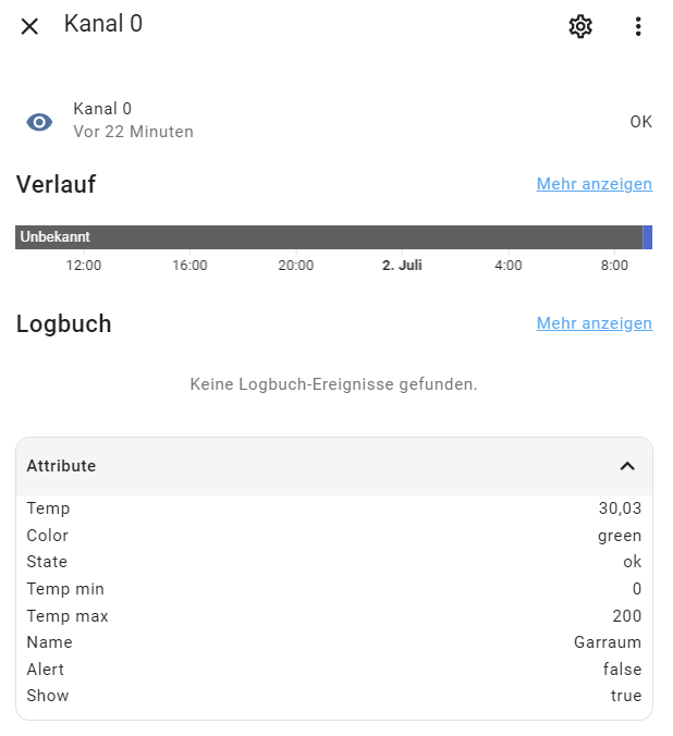

I am trying to set the template to the temp attribute for the entity state the same way I did it with the values in the json root (cpu_temp, cpu_load …) but I am not able to get the value. Tried different syntax and approaches (see below and way more) but nothing works.

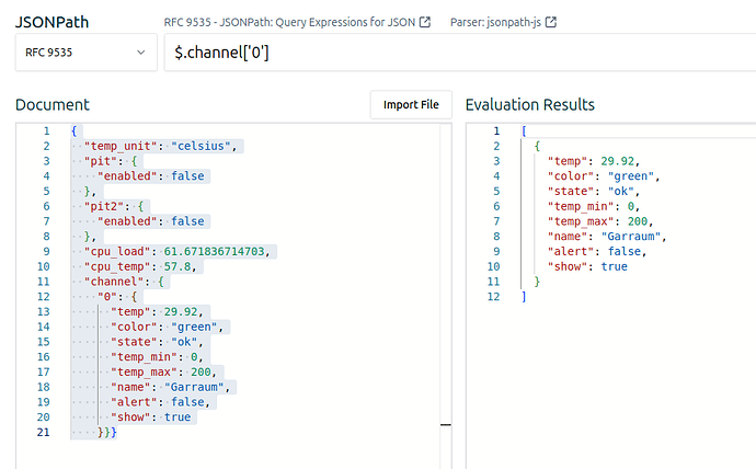

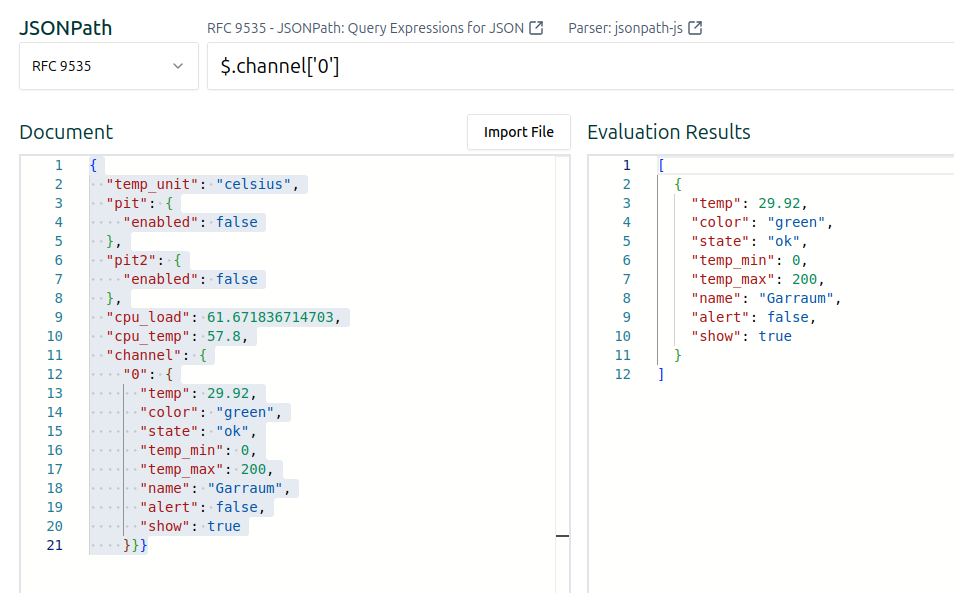

- name: "Kanal 0"

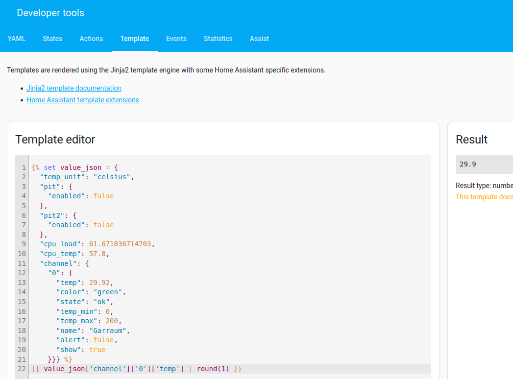

# value_template: "{{ value_json['channel']['0']['temp'] | round(1) }}"

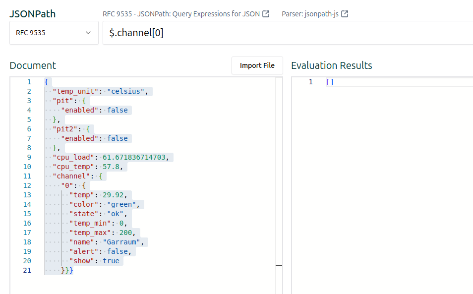

json_attributes_path: "$.channel[0]"

json_attributes:
- "temp"
- "color"
- "state"
- "temp_min"
- "temp_max"
- "name"
- "alert"
- "show"
How do I properly set the value_templates for the specific channels?
