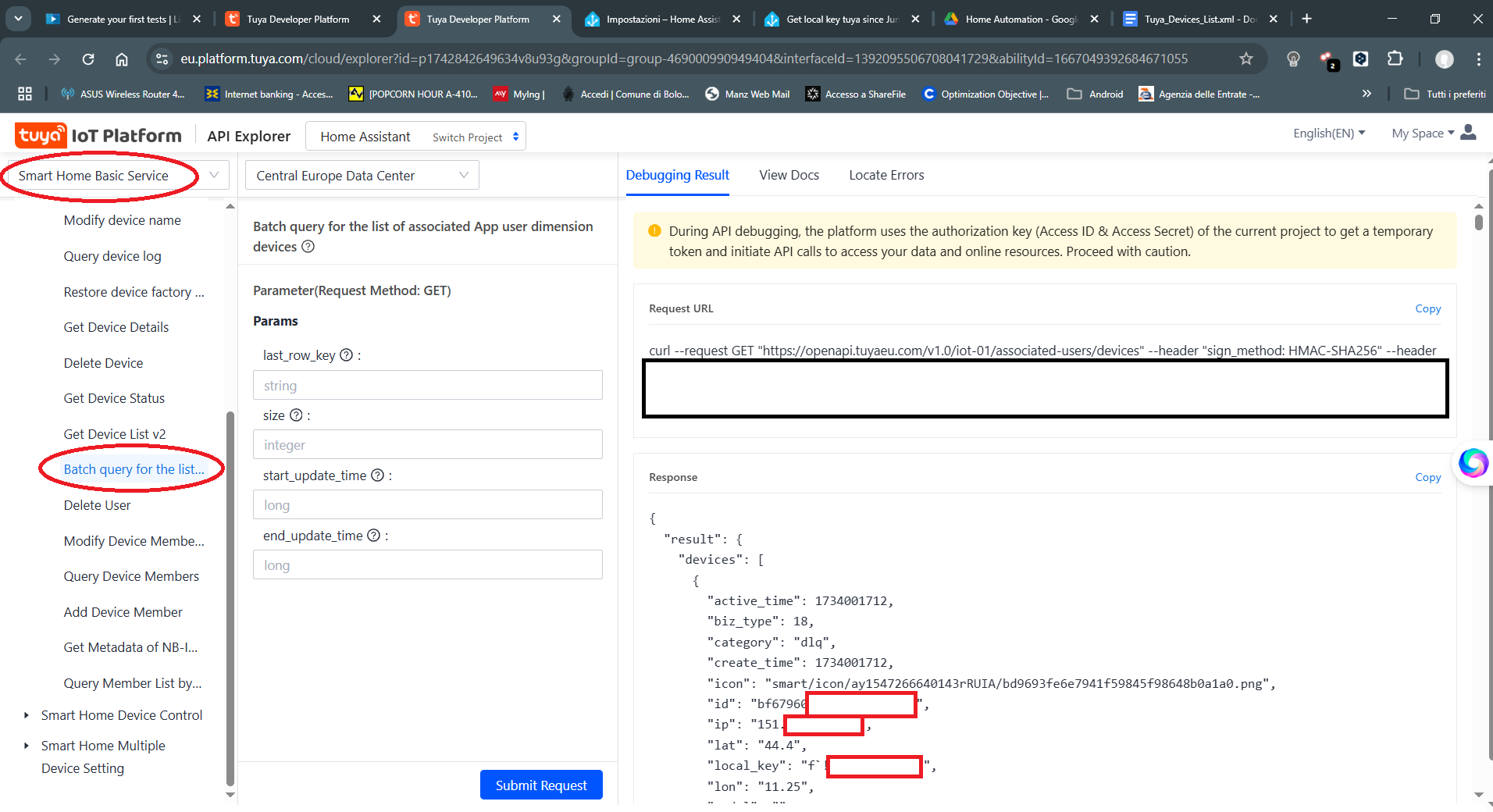

f you have signed up for [iot.tuya.com] (https://iot.tuya.com/) to get your local key, you should also have access to the API Explorer under “Cloud”. Under “Device Control” there is a function called “Query Device Details in Bulk”. Enter the device ID
For anyone struggling with permissions/expired trial, the solution is to simply use API explorer from “smart home basic service”, NOT iot core. You don’t need to extend IoT core trial. The select field for that is at the top left of the page in API explorer. You can then get device details from smart home device management section.

This method is working well to extract all the info about our devices. If you want all of it in a unique file, please see this screenshot.
