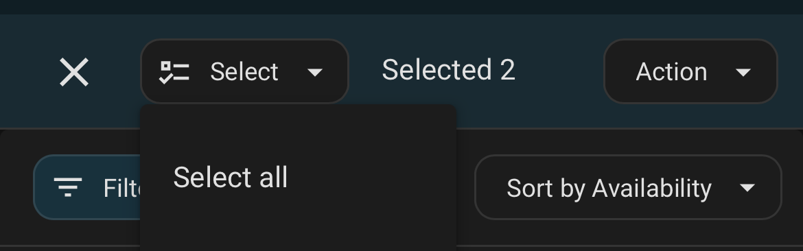

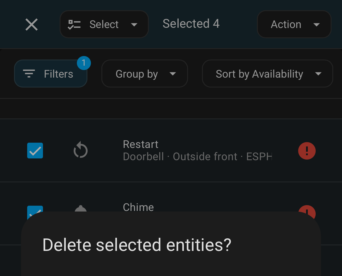

Besides your real issue, selecting and deleting multiple is possible:
You should look for this
icon.
And if you apply smart filtering
you can just select all and hit delete :grinning:
