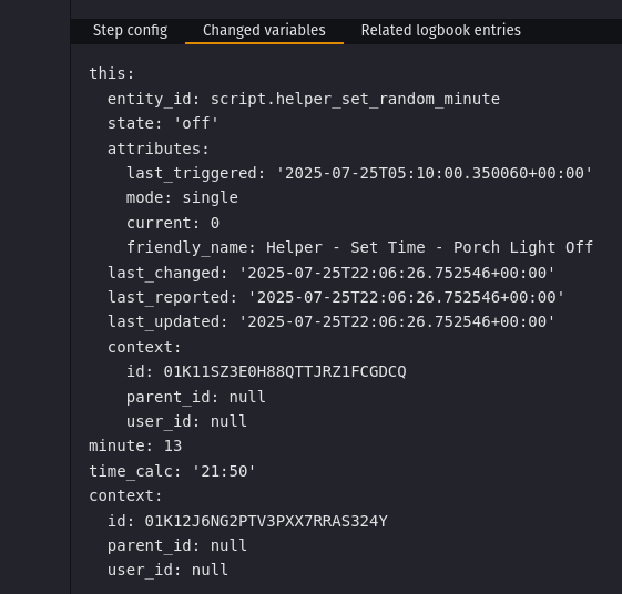

It’s already in the docs… In the first sentence of the explanation of the variable this, it links directly to the page that describes the available properties of the State Object.
You can also find it empirically by going to your script’s debug Trace, then selecting the Changed Variables tab in the lower section. The first thing shown will be all the values of the this variable for that run of the script:
