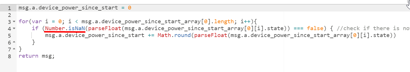

I have never seen that node before.
But I did a quick test and I assume you need to use the function node. The array is multi leveled and if you need to set time parameters then you need to loop the array (I think).
I tried it out and this seems to meet your requests.
Just make sure you set the min and max to values that is above and below what you expect.
[{"id":"c9a655.5d06f9a8","type":"api-get-history","z":"2227cef1.c55b22","name":"","server":"4bbca37b.1700ec","startdate":"2020-08-30T00:00:00+00:00","enddate":"2020-08-30T24:00:00+00:00","entityid":"sensor.andreas_light_sensor","entityidtype":"is","useRelativeTime":false,"relativeTime":"","flatten":true,"output_type":"array","output_location_type":"msg","output_location":"payload","x":430,"y":540,"wires":[["bc2130a4.73ef9"]]},{"id":"5d1ec5bc.5906fc","type":"debug","z":"2227cef1.c55b22","name":"","active":true,"tosidebar":true,"console":false,"tostatus":false,"complete":"true","targetType":"full","statusVal":"","statusType":"auto","x":660,"y":420,"wires":[]},{"id":"760d0ad1.6a6ca4","type":"inject","z":"2227cef1.c55b22","name":"","props":[{"p":"payload"},{"p":"topic","vt":"str"}],"repeat":"","crontab":"","once":false,"onceDelay":0.1,"topic":"","payload":"","payloadType":"date","x":200,"y":540,"wires":[["c9a655.5d06f9a8"]]},{"id":"bc2130a4.73ef9","type":"function","z":"2227cef1.c55b22","name":"","func":"var sum = 0;\nvar min = 2500;\nvar max = -50;\nvar state = 0;\n\nmsg.payload.forEach(function(entry) {\n state = parseInt(entry[\"state\"]);\n sum = sum + state;\n if(state > max) max = state;\n if(state < min) min = state;\n});\nmsg.sum = sum;\nmsg.max = max;\nmsg.min = min;\nreturn msg;","outputs":1,"noerr":0,"initialize":"","finalize":"","x":680,"y":540,"wires":[["5d1ec5bc.5906fc"]]},{"id":"4bbca37b.1700ec","type":"server","z":"","name":"Home Assistant","addon":true}]
And it gave me:
