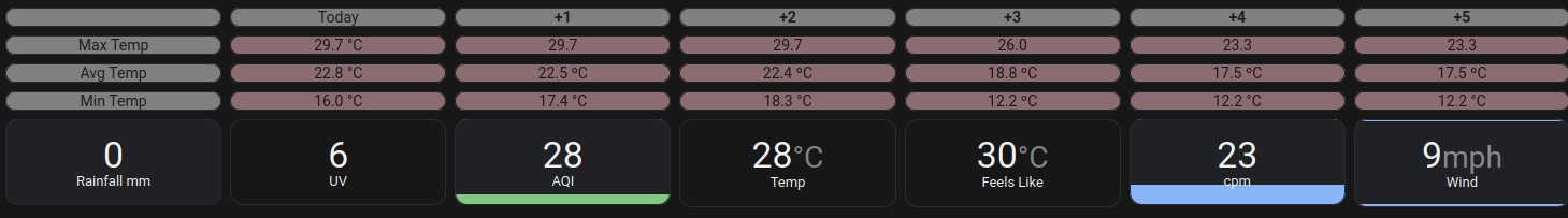

I use this automation and input _number helpers to store the data I want, the automation triggers every evening at midnight and ‘cascades’ the day’s sensor value to the next inline.
i.e.
Today -4 days is stored in today -5
Today -3 days is stored in today -4
Today -2 days is stored in today -3
Today -1 days is stored in today -2
Today is stored in today -1
  alias: "Outside temp history daily update"
  description: Update temp  entities
  trigger:
  - platform: time
    at: '23:59:59'
  condition: []
  action:
  - service: input_number.set_value
    data_template:
      entity_id: input_number.outside_temp_min_24_hr_5
      value: '{{ states("input_number.outside_temp_min_24_hr_4")| round(2) }}'
    data_template:
      entity_id: input_number.outside_temp_min_24_hr_4
      value: '{{ states("input_number.outside_temp_min_24_hr_3")| round(2)}}'
    data_template:
      entity_id: input_number.outside_temp_min_24_hr_3
      value: '{{ states("input_number.outside_temp_min_24_hr_2")| round(2)}}'
    data_template:
      entity_id: input_number.outside_temp_min_24_hr_2
      value: '{{ states("input_number.outside_temp_min_24_hr_1")| round(2)}}'
    data_template:
      entity_id: input_number.outside_temp_min_24_hr_1
      value: '{{ states("sensor.outside_temp_min_24_hours") | round(2) }}'
