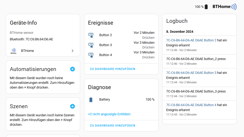

On the problem at hand, good news, the buttons now work. Unfortunately, I can’t figure out any more why and when the changeover happened, but here on HA 2024.12, the events are properly fired:
Meaning I can now make automations, yay!

i had the same problem.
Shelly Wall Switch was delivered to my door.
First i did a firmware update to actual Firmware.
Than i opened home assistant, and as usual HA showed my that there is a new device.
After accepting the new device, it showed up in the BTHome integration. But just signal strenght and Battery.
I went to the internet and searched and searched. no clue…
But than, i accidently pressed one button on the shelly, and suddenly “button2” appeared as an entity.
After pressing button 1, button 1 entity appeard, and after pressing each button every entity showed up.
So my solution was easy: just press each button after HA integration.
