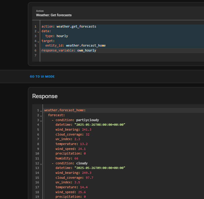

Yes. I didn’t pay enough attention to the action call part which should be:
action: weather.get_forecasts
  type: hourly
  entity_id: weather.forecast_home
response_variable: owm_hourly
When I run this in the Developer tools I get:
I was also struggling with the nested attributes, so how do I interrogate the response to find if the lowest temperature is below 1C? Thanks

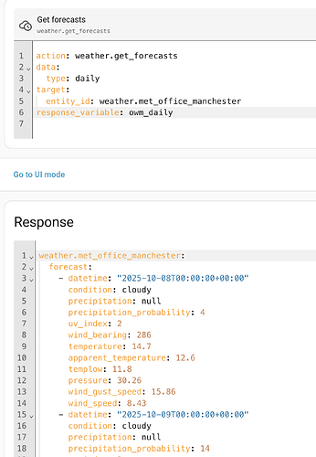

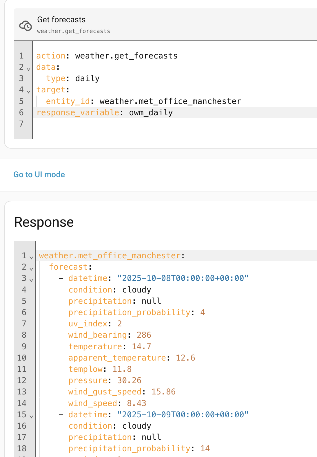

I think I am so close to getting this to work but just can’t complete the last step. Anyone know what goes instead of the ??? to display tomorrows temperature?
automation:
  - triggers:
      - trigger: time_pattern
        minutes: /5
      - trigger: homeassistant
        event: start
    actions:
      - action: notify.android_tv_fire_tv
          message: "Getting Weather forecast"
      - action: weather.get_forecasts
          type: daily
          entity_id: weather.met_office_manchester
        response_variable: own_daily
          message: "tomorrow's temperature is ?????"
The get forcast action seems to work if called from the action facility in the debugger and I can see tomorros temperature
