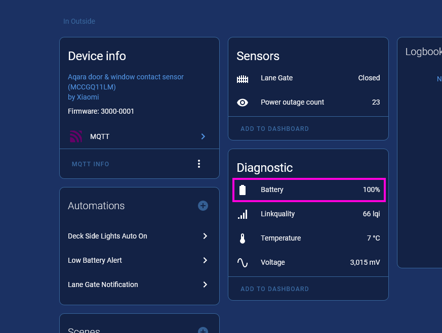

When you go to the device page is the battery state listed in the device Diagnostic Card?
e.g.
