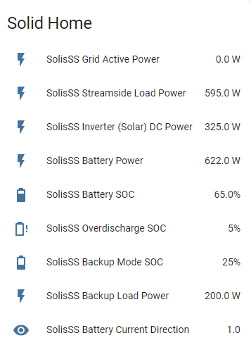

Which sensor gives the actual house usage/draw? (ignoring solar & battery)
Using LAN stick direct & using foboundy’s relative easy & straight forward HA coding, all works great.
read info & now got it to adjust Econ7 overnight charge times depending of how sunny the following day but that’s another story.
33147 House load power … Load power which is the active load is not actually correct.
Surely should be 947 W (small solar generation & rest from battery)
Now I have added the backup circuit & that is separate & uses the 200W as shown
So likely this is not in the load power but even 595 + 200 = 795, still 150 W out.
Battery power + Solar power IS correct - I can set up a calculated sensor but would like to understand.
Solis cloud has the correct KW - perhaps that even does it via calculation?
Any info.

to check this, we need all values. Where is your house load power? What is Solid home?
