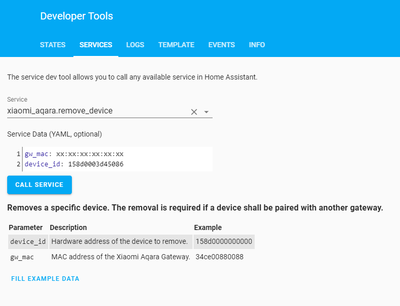

I have moved two sensors from being connected to one Xiaomi gateway to another Xiaomi gateway. Now I’m getting the error “Entity id already exists” in the log file. Sometimes the sensors are showing as “unavailable” sometimes they are giving values, but I haven’t been able to see a clear pattern. The sensors are a temperature/humidity/pressure sensor (158d0003d45086) and a motion sensor (158d0004470bb2), as can be seen in the log file below.
Both gateways are connected to the network and sensors, which have not been moved between gateways, are working fine. In the Xiaomi app the two sensors are shown correctly as children to the new gateway and they are connected and giving values as expected.
I assume that there is an old unique ID stuck somewhere in a configuration file and maybe being linked to the original gateway, but I’m simply unable to find it. I have checked in .storage\core.entity_registry but each sensor is only listed once.
Any help would be appreciated.
