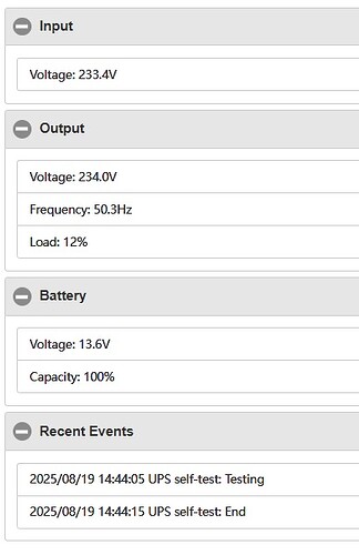

i have an old ippon basic 650 euro, through the winpower program i get a web interface that can be transferred to HA.
Thanks for the topic and examples. My configuration:
/homeassistant/configuration.yaml
rest:
 - resource: "https://192.168.1.98:8888/0/json"
   verify_ssl: false
   sensor:
     - name: "UPS_Batcapacity"
       value_template: "{{ value_json.batCapacity | replace('%', '') | int }}"
       device_class: battery
       unit_of_measurement: "%"
     - name: "UPS_Status"
       value_template: "{{ value_json.status }}"
     - name: "UPS_Load"
       value_template: "{{ value_json.loadPercent | replace('%', '') | float}}"
       device_class: power_factor
     - name: "UPS_Battary"
       value_template: "{{ value_json.batV | replace('V', '') | float }}"
       device_class: voltage
       unit_of_measurement: "V"
     - name: "UPS_TimeRemain"
       value_template: "{{ value_json.batTimeRemain }}"
     - name: "UPS_Freq"
       value_template: "{{ value_json.outFreq | replace('Hz', '') | float }}"
       device_class: frequency
       unit_of_measurement: "Hz"
     - name: "UPS_OutVolt"
       value_template: "{{ value_json.outVolt | replace('V', '') | float }}"
     - name: "UPS_InVolt"
       value_template: "{{ value_json.inVolt | replace('V', '') | float }}"
     - name: "UPS_Temp"
       value_template: "{{ value_json.upsTemp | replace('C', '') | float }}"
       device_class: temperature
       unit_of_measurement: "°C"
