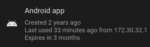

The config is definitely loaded (if I misconfigure anything it’ll fail to start) and I also tried with the default X-Forwarded-For (in fact that was my fist few tries, but then I tried to reproduce their Cloudflare config). But in the end while funnily enough IPv6 IPs sometimes seem to be passed though in general all the tokens still note the internal Proxy/Docker network routing IP:
