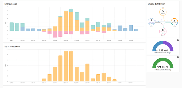

Here is my energy balance on a very overcast afternoon when my scheme failed me. The blue is energy from the grid.
