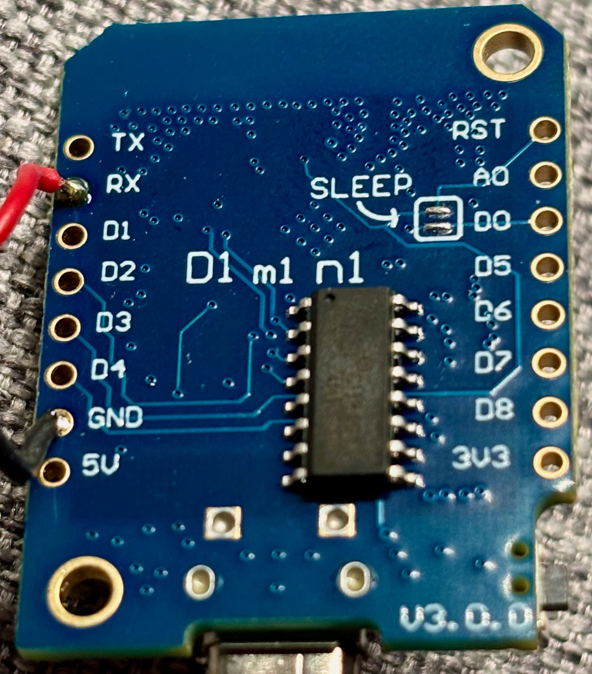

I’d like to use a D1 mini (connected to an external speaker with a jack cable) as a media player. The whole idea is to use it to read notifications sent from Home Assistant.
The jack cable (mono) is connected to the RX and GND pins:
This where my struggles start.

You will soon find out that esp8266 doesn’t have DAC or I2S.
Get Esp32 (like your title says) and MAX98357A.
