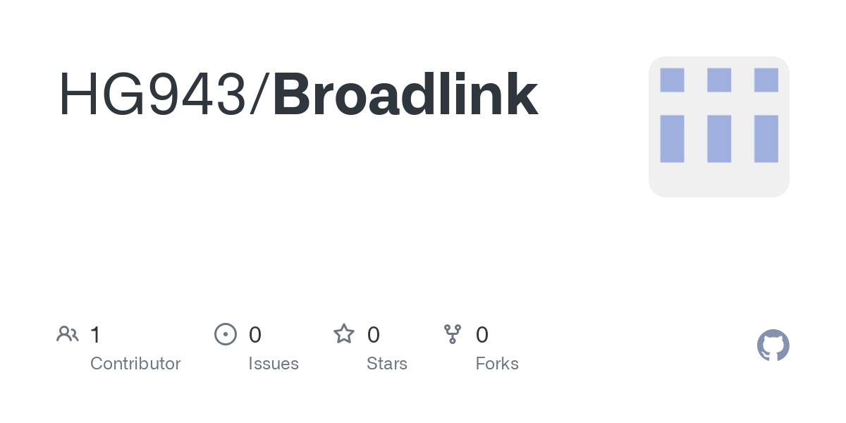

I created an Excel file that converts Nexa RF codes (input is house code and unit code) and generates the codes for Broadlink. I did this as I wanted to move from Telldus to Broadlink without having to re-learn codes for all my switches.
It can also batch generate Broadlink codes from a list of Nexa codes and generates a file that can be copied directly into switches.yaml
Should be possible to convert to other formats also (if you know them).
Not sure how to share the excel file though, as it can’t be uploaded to this forum.
Do you know how to use Git or have a GitHub account? I’d love to check that out from an interest perspective. I don’t have those devices but I’m curious how you put all that together.
Ok, try this then:
You´ll need to enable macros in excel since there is some VB code that needs to run.
Let me know what you think :slight_smile:
