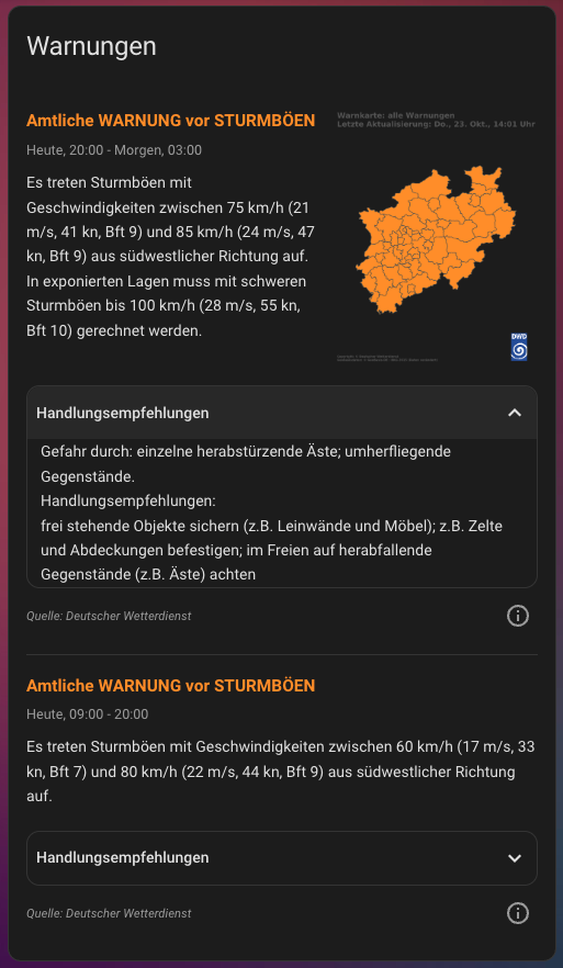

Getting Started with NINA Integration
Although this thread is a little older, someone may be interested in my realization of NINA.
I made the NINA visualization for the available integration with a markdown card.
With this code I solved the problem with 5 sensors. They are all displayed in one card with a loop, separated by a horizontal line. The headlines are colorized according to the warning level.
If you like to ignore messages from dedicated sources like DWD you can add a variable which contains the attribute “sender” and a conditional line in the loop.
Instead of xxx in the code below fill in your selected sensor name without the index in the last character. The index is added from loop.index. The sensor name can be found in the developers section of HA.
Testing is possible if you do not block the covid messages in the integration. But of course you can choose a station with actual messages to test it, too.
Feel free to optimize it your way - and let me know :wink:

In case someone is using my markdown template I posted last December (Getting Started with NINA Integration - #22 by spacegaier): I just updated that because it was not able to gracefully handle NINA entries that do not have a start and end time set.
I just had this scenario with a potential upcoming bomb disposal warning. The template will now print “Unbekannt” if no time is provided for one of those data points.

I’ve implemented an easier way to show the NINA (and DWD weather) warnings. :blush:
My new post:
Thank you for providing this interesting new card.
DWD is running fine, but I got stuck with the nina acess:
type: custom:nina-dwd-card
title: Warnings 20251024 (test)
nina_entity_prefix: binary_sensor.warning_berlin_stadt   #"11000000"
max_warnings: 3
dwd_device: 1219e6af4302c36cf25721af5ec8c3b3
dwd_map_land: bbb
hide_when_no_warnings: true
However, the config-Editor “Nina Warning Area” dropdown remains empty.
