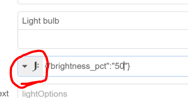

I´m quite new to HA and getting started with the Node Red, but I’m struggling with a setup that I thought would be super simple.
I want to turn on the light to a specified brightness with a click of a button.
I only managed to turn on the light, but as soon as I add the brightness to Data field, I get different kind of flickering and inconsistent behavior from the WiFi bulb I’m trying to control
I would appreciate if someone could point me in right direction.
Below is my call service node.

I assume you’ve tried it without the quotes around the 50 ?

Try changing this:
And then use { "brightness": 128 }
It might work if you just remove the " from 50. It’s a numeric value it wants, not a string

Just tried, but same problem. The light just flickers and returns to the brightness it was set previously.
