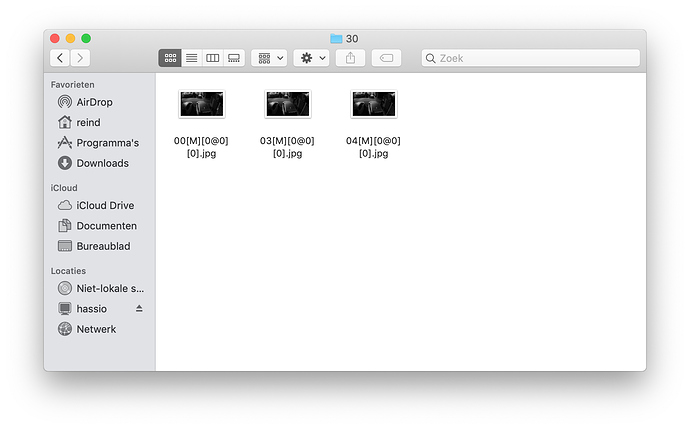

Currently i have my IP cameras uploading snapshots when motion detected to the /share folder at my hassio installation. This all works great with the ftp addon i’m using and every time the camera detects motion it uploads the snapshot to my hassio install and it places the video recording on a nfs drive on my nas.
Works great BUT now i want to use the last uploaded snapshot inside my new lovelace setup with a picture glance.
The problem i have is, how do i get the last uploaded file? I tried the folder_watcher but i can’t get my head around how this thing should work to get the last uploaded file. Another option was the file_sensor but since my camera uploads in a folder structure based on date / format / hours / minutes / image.jpg this doesn’t seem to work also because the folder structure changes during time.
Anyone having a suggestion to get the last file uploaded inside /share/dahua/camera_name/ and is able to look also inside the time based subfolders?
