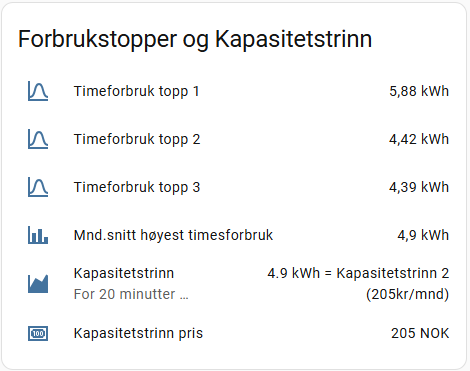

Thanks for this! My energy-company will now charge us for the averange value of the 3 highest power-tops each month. So I guess I just copy your code, and then make a template sensor that adds the values of the 3 input-numbers and the divide it by 3?
Actually, my company counts the 3 days with the highest power-tops. This code take the 3 highest per day, right? Is there anyway to change the code so that it sort it one input-number per day so to say?
Waking up this thread.
@MrGlad8 Did you find a solution for this?
The automation above counts the three highest hourly peaks for one month.
You need to set up three input.numbers helpers that resets monthly.
To calculate the average peaks I added this to my configuration.yaml
      - name: Timeforbruk topp 1
        unit_of_measurement: 'kWh'
        state: >
          {{ states('input_number.timeforbruk_topp_1') | float(0) | round(2) }}
      - name: Timeforbruk topp 2
        state: >
          {{ states('input_number.timeforbruk_topp_2') | float(0) | round(2) }}
      - name: Timeforbruk topp 3
        state: >
          {{ states('input_number.timeforbruk_topp_3') | float(0) | round(2) }}
      - name: Mnd.snitt høyest timesforbruk
        state: >
          {% set xtopp1 = states('input_number.timeforbruk_topp_1') | float(0) %}
          {% set xtopp2 = states('input_number.timeforbruk_topp_2') | float(0) %}
          {% set xtopp3 = states('input_number.timeforbruk_topp_3') | float(0) %}
          {% set xtotal = (xtopp1 + xtopp2 + xtopp3) / 3 %}
             {{ xtotal | float(0) | round(2)  }}
