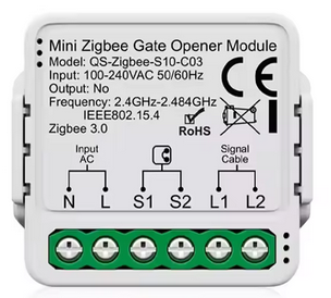

I’ve spending hours getting this mofo module to work;
Aliexpress Gate / Garage door opener QS-ZIGBEE-S10-C03
Zigbee ID; _TZE608_xkr8gep3 TS0603
( Winkelinformatie bought with; SanTao Smart Home Store Winkel-ID 1103749276)
Apparently the module does not send a pulse when the reed contact is opened.

But I noticed, that opening de garage door went fine. But when pressing the button again to close it, nothing happens. I saw the command go to the Zigbee module. But the module didn’t respond. When pressing the button on the Zigbee device, it would close the garage door. ! WTF !
So apparently the zigbee hardware device decides not to send the pulse once the magnetic reed contact is in the state ‘open’. Very funky, perhaps there is a way to configure module not to act like this.
The thing is, my other garage also has a comparable Zigbee device; _TZE608_fmemczv1 TS0603), that does not display this behavior.
Anyways, this is simply omitted when just bridging the contacts that would be used for the reed contact with a wire. S1 and S2 on the module. This way the module always sends the pulse.
Hope this saves someone the hours I’ve spend troubleshooting this like I did. A thank you when it did is appreciated.
Maybe somebody knows a way to change the settings for this device? Or how to get this module incorprated in the ZHA lib…?
