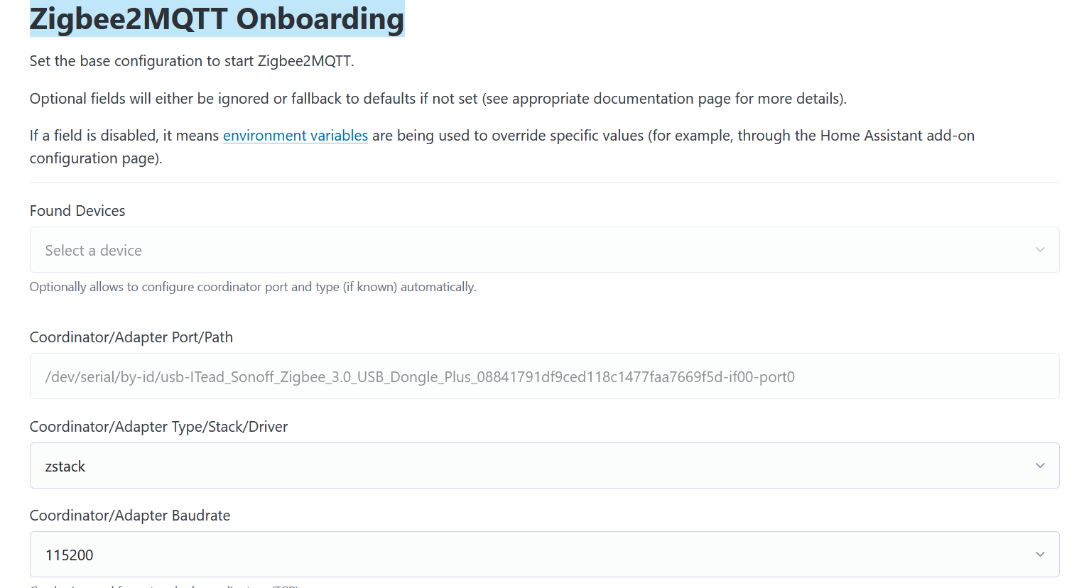

but getting to the onboard
i think it means it can’t find the device
what to do

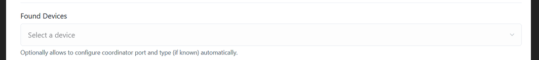

i get the onboarding screen,… but then what… it should show that you can add devices

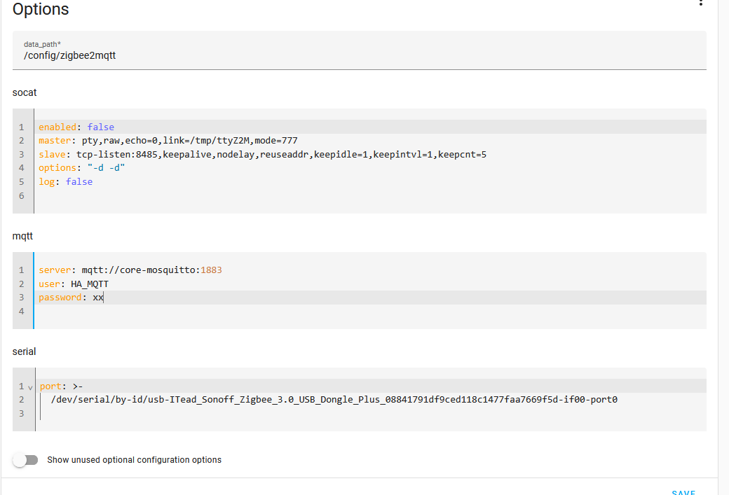

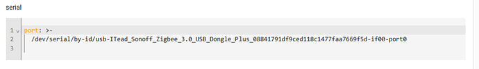

Not if you already filled out the config fields, at least from my experience.

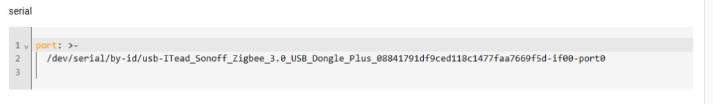

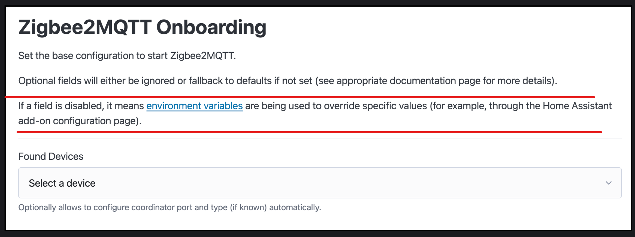

It is specified here
The configuration tab overrides onboarding
i don’t understand what that means
It means if you add data on the Z2M config tab under mqtt and serial, it overrides the onboarding fields. That makes the Found Devices selection area unavailable in the onboarding interface
your code here
disables this
From my perspective, the Onboarding feature was designed to help with the install. When running Zigbee2MQTT via the Home Assistant, the addon ports are pre-determined.
The HA addon requires the frontend to run on port 8099 and needs the onboarding when it’s without a complete config file. This is adding confusion during installation based on the available documentation.

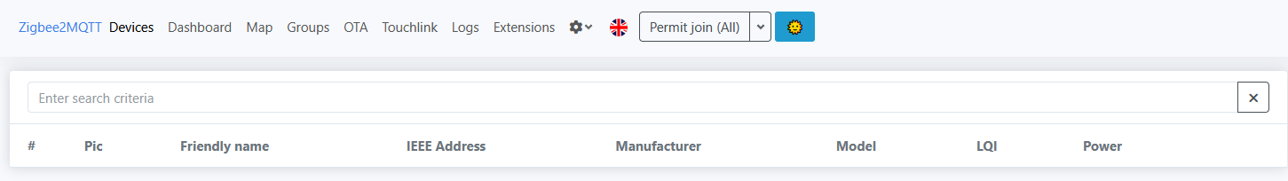

but then why am i getting this instead of the page to add devices
(thanks for taking your time to help me)
getting what? I don’t understand what you mean by this.
Where do you expect to see a page to add devices ?
yes i expected to see this… but i get the onboarding… i expect that when i hit the tab zigbee2mttq
If you did not go through onboarding, that page will not show.

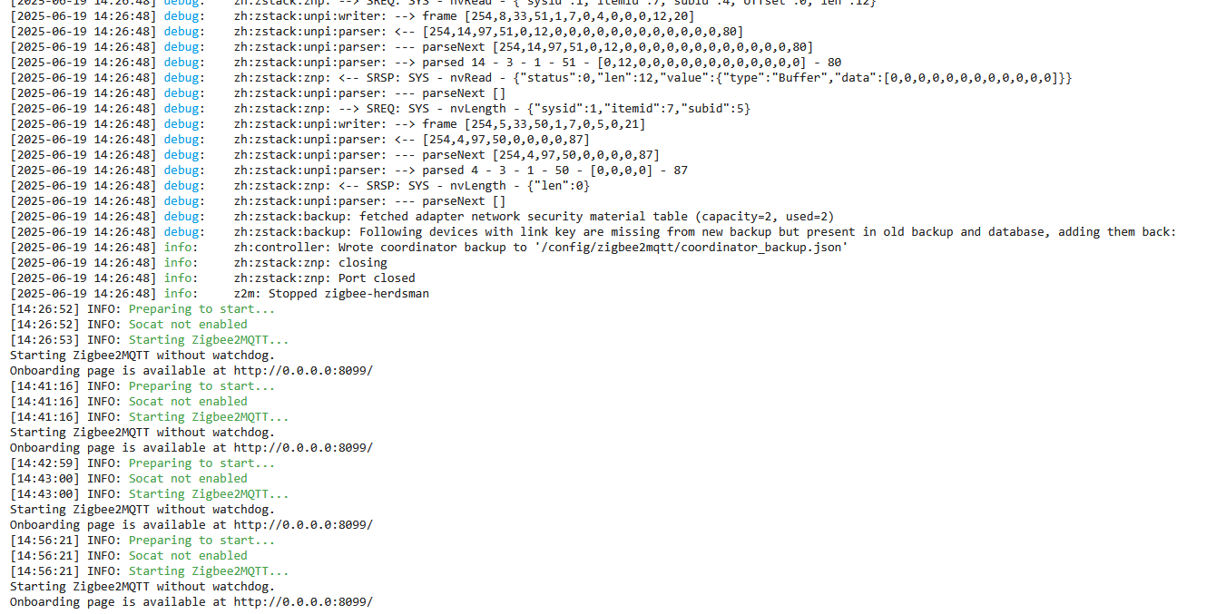

A shortcut is to edit /config/zigbee2mqtt/configuration.yaml, end delete the line
onboarding=true
but make sure zigbee2mqtt is stopped before you do that.
onboarding is more trouble than it’s worth :man_facepalming:
i don;t have that in the file…
but maybe i can add it some where with the parameter false?
but where

What does your Mosquitto broker logs look like ?
thank you that was it it was turned off
Happy it’s working!!
Good it is working. Just deleted the add-on, it was there when started again

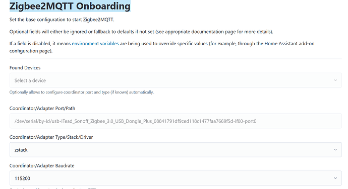

version: 4
mqtt:
  base_topic: zigbee2mqtt
  server: mqtt://localhost:1883
serial: {}
advanced:
  log_level: info
  channel: 11
  network_key: GENERATE
  pan_id: GENERATE
  ext_pan_id: GENERATE
frontend:
  enabled: true
  port: 8099
homeassistant:
  enabled: true
onboarding: true
But you found the problem
I’ll try the same, but it’s (onboarding: true) not in my config.
One caveat…
I went back to 2025.5.3 until I figure out why I am having issues with my pond valve.
renamed the existing /config/zigbee2mqtt to /config/zigbee2mqtt_, then reinstalled, or it kept the existing configuration.
