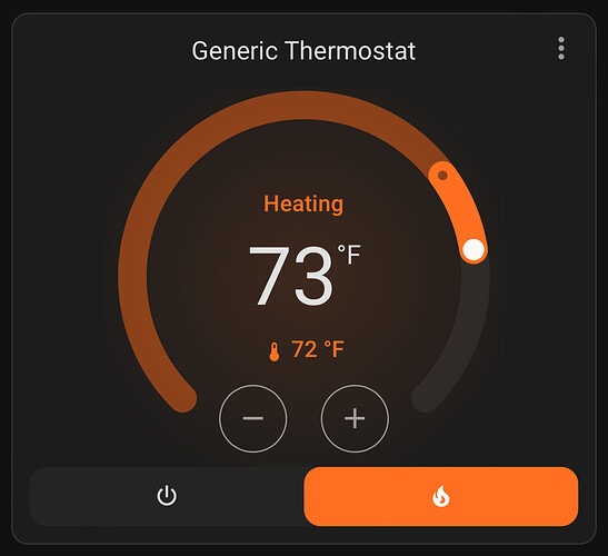

Hi all - It looks like the Generic Thermostat method referenced above requires the thermostat to work as a switch. I have a Nest thermostat which comes into HA as a climate entity. So I’m unable to go this route. Still looking for another route.
Make yourself a switch entity…
There is also a custom integration, Template Climate, that is kind of a combination of Generic Thermostat and a Template switch rolled into a single entity.
Doesn’t explain how to physically turn your climate/thermostat on. I used my existing thermostat as the “switch”. But I don’t see how you force the physical thermostat to turn on heat just because the generic thermostat says it should be on? I’ve used a temp sensors in another room (72°), I’ve set the generic thermostat to (73°), and it says it’s heating.
But the temp at physical thermostat is actually 74°, so it won’t actually turn on heating.
It can be different depending on the end device. The most common method is to use the turn_on and turn_off configuration variable of the Template Switch to construct sequences of actions which set the physical thermostat set point to an appropriate value. This can be an extreme value that will never actually be met or a more specifically adjusted value.
I thought about doing that just seems a bit sketchy. I’ll have to noodle on it a bit more before going that route.
I assume your physical thermostat is dumb, as is mine (otherwise you can control it directly so don’t need the generic thermostat ?). The physical thermostat setpoint is set to an arbitrarily large temp eg 50oC so that the physical thermostat is always on.
Then, control is handled by the generic thermostat turning on/of the device controlled by the physical thermostat (in my case, a relay that turns on/off a hydronic circulation pump).
Of course, you could just remove the physical thermostat completely.
