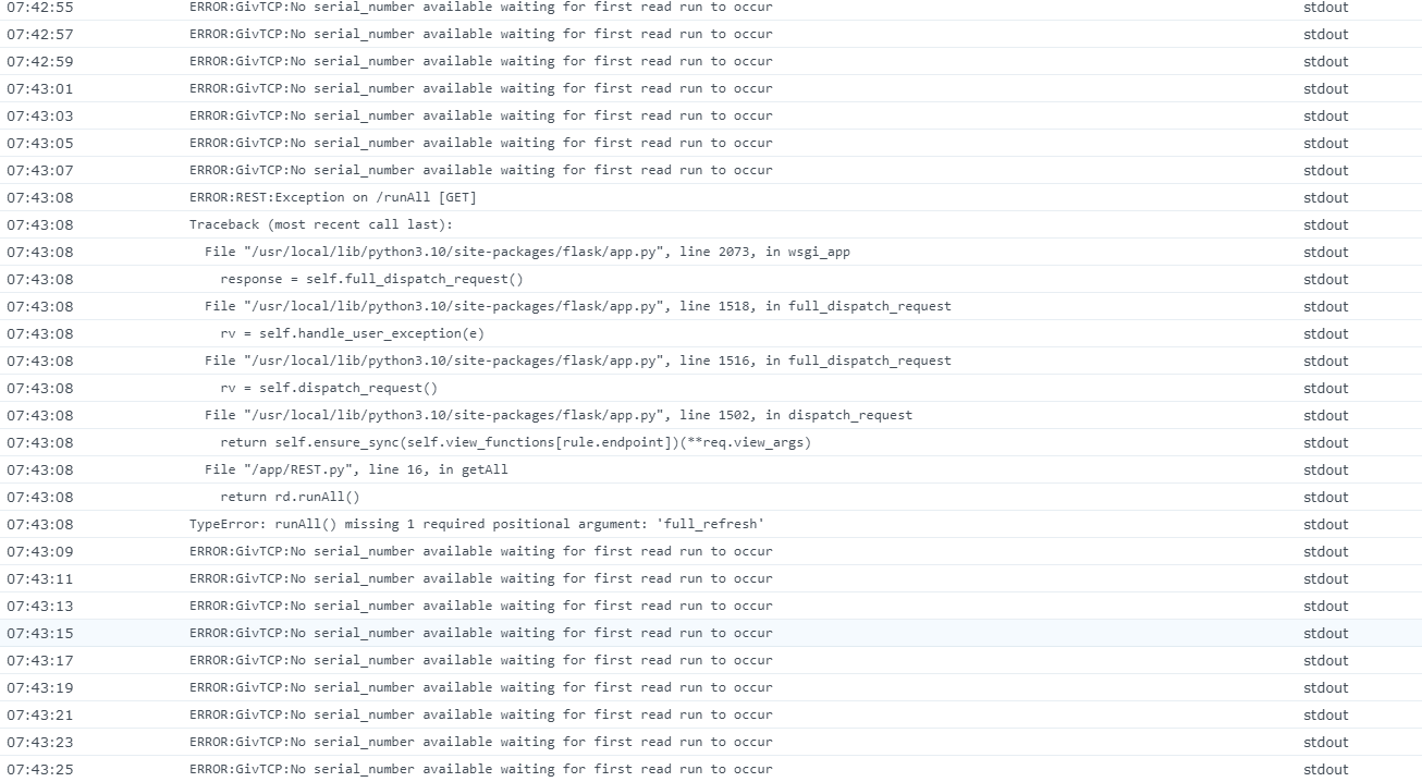

Unfortunately this is what I get at the moment - once this goes away I’ll see how to connect through MQTT
Got it connecting and givtcp things have appeared in HA. Which is great. It’s only got sensors at the mo, I can’t yet find a switch/state for anything. project for later.
Ok, what was the error that you managed to fix??
Using the wrong container! Was using dev, not dev2. Now it’s giving reasonably reliable readings though they did disappear from HA for a while last night. However, no controls in the mqtt discovered entities.

ā€œDevā€ is the right container to use, but there was a bug! I’ve fixed it and uploaded a new dev image.
Try it out and you should get switch etc for control
thanks - Dev now starts but gives this error:
Ah, (yet another) error on my part. I forgot to push the updated REST.py file to match the changes. New container pushed to dev which works now.
