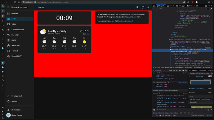

Just found out your plugin and its great… but I’m not achieving what I want… Can you help me? I want to somehow limit the canvas/panel to a size, so that I can precisely position widget so that I could take a snapshot to upload to an eink display. My display is 800px to 600px so It would be great if I could add a size restriction (and a background) to see if I’m drawing inside my eink visible space.
This is what I want to achieve (done manually in Zen)
(This is what I want to achieve)
Based on your github, the theme should be:
# themes/test.yaml
test:
  small-layout-path: "/lovelace/"
  small-layout-selector: home-assistant-main$ha-drawer partial-panel-resolver ha-panel-lovelace$hui-root$
  small-layout-style: |
    hui-view {
        height: 600px !important;
        width: 800px;
        background-color: red;
For some reason it is not failing now (before it was saying something about null), but is doing nothing… What am I doing wrong?
Thank you!!!
You were almost there. Home Assistant can be a CSS beast :wink: .
  small-layout-path: "/dashboard-small/"
    div:first-of-type {
      --view-width: 800px;
      --view-height: 600px;
      /** Hide any overflow items exceeding set height.
          This can break or hide cards that want to overflow! */
      overflow: hidden;
    #view {
        width: var(--view-width);
        min-height: var(--view-height);
        background: red;
The height should be defined within the view container. If you want an alternative width without resizing the navbar you can use the hui-view element if you want to.
I recommend against using the overflow property. But I’ve included it for completeness
