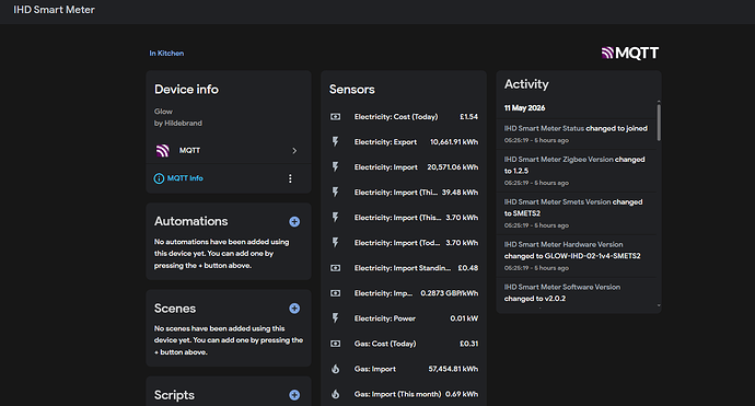

IHD
Start by setting up your MQTT details on the IHD. The settings steps can be seen in the video on this article https://medium.com/@joshua.cooper/glow-local-mqtt-f69b776b7af4
The instructions below are set for the default topic glow
Home Assistant Entities
Go to Settings -> Automations & Scenes -> Scripts -> Create script -> Create new script -> ... -> Edit in YAML
Use the following YAML file.
  • Replace ihd_id: REDACTED with your ID. You can either get it from your MQTT broker using something like MQTT Explorer, or direct from the IHD screen (Go to Wifi, note the mac address, remove the colons :)
  • Note the topic in the configuration. The new sensors are saved in homeassistant/sensor/IHD_ID and are based on data from glow/IHD_ID/

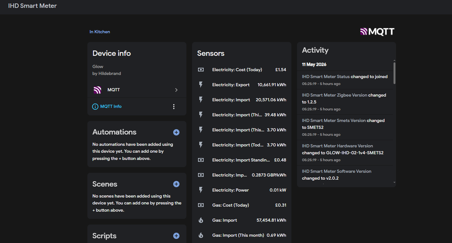

Save the script, then run it (... -> Run)
  • This will bring in all the relevant entities.
  • The entities are then grouped as 1 device.
  • You can keep the script for any future thinkering. If you change anything, you just need to Run the script again

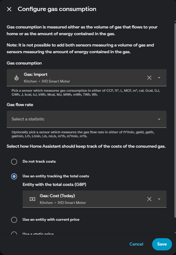

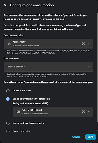

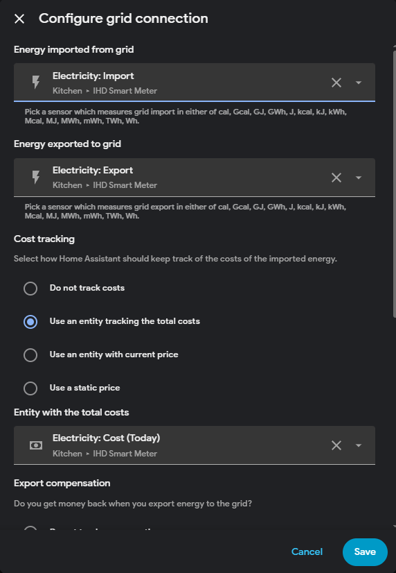

Home Assistant Energy Dashboard
The entities we need to use are as follow:
NOTE: Some meters are reporting figures in MW, so the there will be a difference of a factor of 1000. If you are affected by that, here is a workaround for the cost entities:
"value_template":"{{ "{{ (states('sensor.glow_ihd_smart_meter_electricity_import_today') | float(0) * 1000 * states('sensor.glow_ihd_smart_meter_electricity_import_unit_rate') | float(0) + states('sensor.glow_ihd_smart_meter_electricity_import_standing_charge') | float(0)) | round(2) }}" }}",

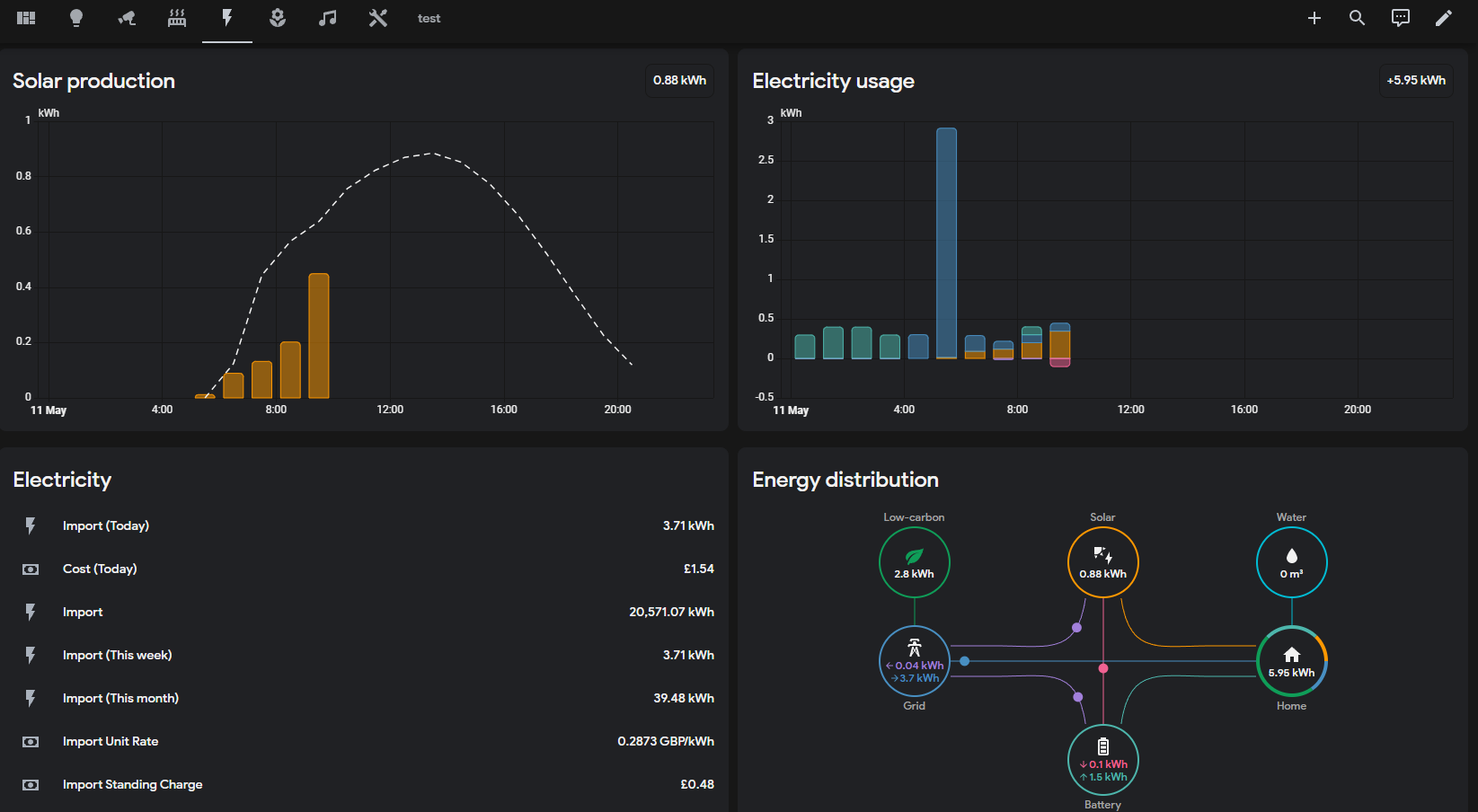

Bonus Content
Did you know you can replicate the Energy dashboard in Lovelace, and then include your own other entities?
