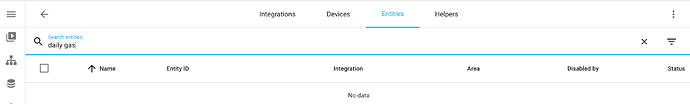

I have also checked /config/.storage/core.entity_registry for daily gas and daily_gas but no entity exists
Can you please search the entities by their unique_id instead of the human name? I still find it very hard to believe they are not there. Not that i don’t trust your word, just that it is suuuuch a weird one that makes no sense whatsoever.

When I search by unique ID the entities still dont show (including having all filters removed):
Even when I try by the generated UUID I get no results from the other sensors where I changed the entity_id.
@BertrumUK I gave that a go searching for ‘gas’ - I get a lot of hits but not the ones that should have been created from MQTT for ‘Daily Gas’:

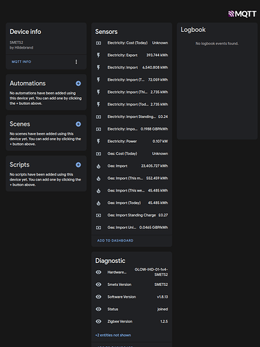

@robertalexa @BertrumUK now this is strange. I added the “Daily Gas” code that you put up @BertrumUK into the electric import file (entity name was amended a couple of days ago to not loose historic data when stripping out GlowStick code)……….and the entity was created! The file now reads:
mqtt:
    - name: "Electric Meter Import Raw"
      unique_id: 4e6df54d-fdef-436f-83b5-034a1f25c942
      state_topic: !secret smart_ihd_state_topic_electric
      device_class: "energy"
      unit_of_measurement: "kWh"
      state_class: "total_increasing"
      value_template: >
        {% if value_json['electricitymeter']['energy']['import']['cumulative'] == 0 %}
          {{ states('sensor.smart_meter_electricity_import') }}
        {% else %}
          {{ value_json['electricitymeter']['energy']['import']['cumulative'] }}
      icon: "mdi:flash"
    - state_topic: !secret smart_ihd_state_topic_gas
      name: "Daily Gas Import"
      unit_of_measurement: 'kWh'
      value_template: "{{ value_json['gasmeter']['energy']['import']['day'] }}"
      icon: 'mdi:transmission-tower'
      device_class: energy
      state_class: total_increasing
