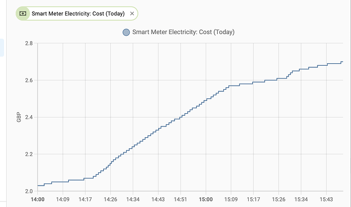

Yes, I’ve had this for ages for both gas and electricity - it’s really annoying, I can’t see why it’s doing it, if i create a manual graph card to show the costs they look fine.

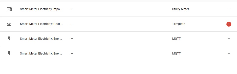

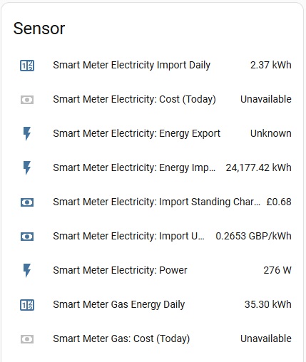

Hi, I don’t know if this topic is still live or not but I will post anyway…
I just got an IHD from Glow and it works well. I followed the setup and the information in this post to get it up and running with HA and all went well except the entities calculating cost for the day.
I added the template to create the sensors to capture cost for the day and added to the HA config and it works, in the sense that the entities are recognised but they have no values and never update. See attached pics.
Given that others have managed this everything should have worked, don’t know what I am doing wrong.
Help much appreciated…many thanks.

Make sure your other state sensor names are correct is the main thing I can recommend.
Here is my code that works.
If you post your code on here someone will be able to help….

Thanks Sealine and hassio. I see the code being the same in my install yet it doesn’t work. Let me have another look at it and see if I can get it sorted. I may be back…!
Okay, sorted! The setup further above in this thread posted by robertalexa is what I used as my setup - at least I thought I did. Actually I got it from elsewhere and it was different but not that I noticed. Where I saw a problem was the additional template by robertalexa calculating cost, but it didn’t work because the sensor entities didn’t exist in the configuration I had copied. It took me a while to find this out though but it is looking good now. So, thanks to those leaving some code for me to consider, it lead me on the right track to fix it. Cheers.
