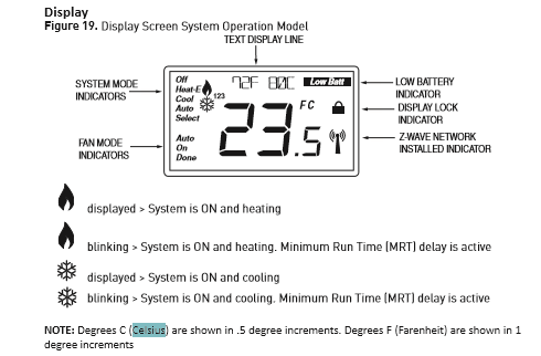

Only problem is that after switching the thermostat to celsius, it doesn’t seem to accept 0.5 degree increments. My automation is setting it to 21.5 and it automatically resets to 22, even though the thermostat spec sheet shows it can do 0.5 C increments.
So, what does this mean in terms of setting the thermostat to 0.5 C increments? Seems like HASS sends the half degree value, and then the device sends back that it was set to the nearest integer.
