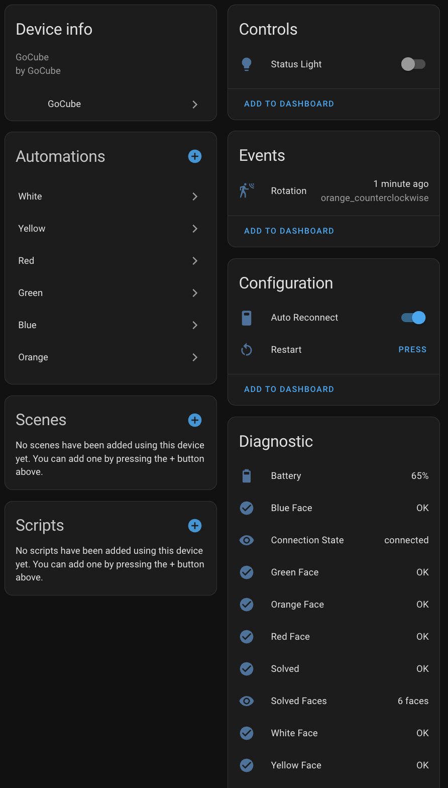

GitHub - anthonyangel/gocube-ha: Home Assistant integration for GoCube can be installed as a custom repository through hacs, and then the Cube appears in Home Assistant, it currently supports:
  • Binary sensor for each face
  • Binary sensor for the whole cube solved
  • Rotation events, including colour & direction
  • Battery
  • Lights
Thanks for the great integration. Works perfectly.
Is there a way you could add a particular state of the cube (example - cube solved and then one face rotated CW twice) as a sensor?
Currently it is easy to trigger automations off of either cube being fully solved only. Everything else seems hard to do.
Thanks again!
