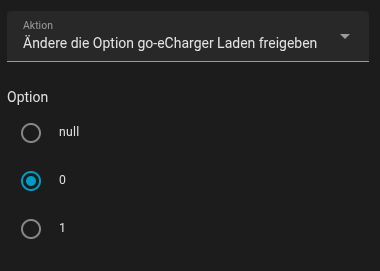

thank you so much for this intergration!
Iḿ realy satisfied with it, it works great for pv-charging.
I created a automation to start an stop charging via grid in winter time.
Start charging works great with “Ändere die Option go-eCharger Laden freigeben” to “1”.
To Stop charging I tried to change same Option to 0, but it does not work.
So I’m wondering how I can easily stop the charging process.
I haven’t found any other option for this.
force stop charging? see here:
This was rubbish.
