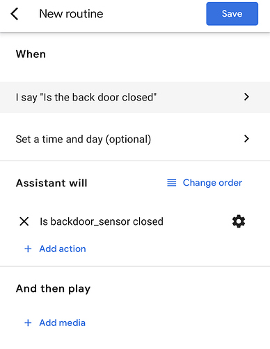

Just a thought on your problem, have you tried typing a request into assistant to see if it knows what you mean? I was able to replicate this problem with my door sensor in english. If I speak to google home asking it about my back door, it doesn’t work, but if I type it on the phone, it works.
If that works for you too, then just create a new routine in google home, setting the trigger event as the phrase you want in any language, and then in add action, just type whatever text that worked on your test. like this below.
If you’re having trouble with french, maybe also try to type it into assistant in English and see if that works too? It maybe a translation issue on google side. Good luck!

Please try this test: open your assistant app on the phone, switch to the keyboard and type the request in English. Be sure to explicitly address the door sensor exactly as it is named in Google Home. Like: “Is the backdoor_sensor closed?”
If Google assistant comes back with the correct status of the door, you’re in luck, and my suggestion above will work for you.
In the Google Home app, tap “routines”, slide down to the bottom of the routines menu and tap “manage routines”. In the next screen, tap “Add a routine”. In the blank new routine, tap “Add Commands”. The command you add will be what you say verbally to your Google Home/Nest speaker. So add it in French (something like “La porte arrière est-elle fermée?”). You can add as many ways that you might ask the question to google verbally here, so be sure to add a few. After you’ve done that, in the “Assistant will” section, tap add action. This is where you type in English, the command that worked in your test, like “Is the backdoor_sensor closed?” Once you are done, you can speak to your google home speaker in French, and it will send off the request to google assistant in English, and answer you back with the state of the door in the default language.
