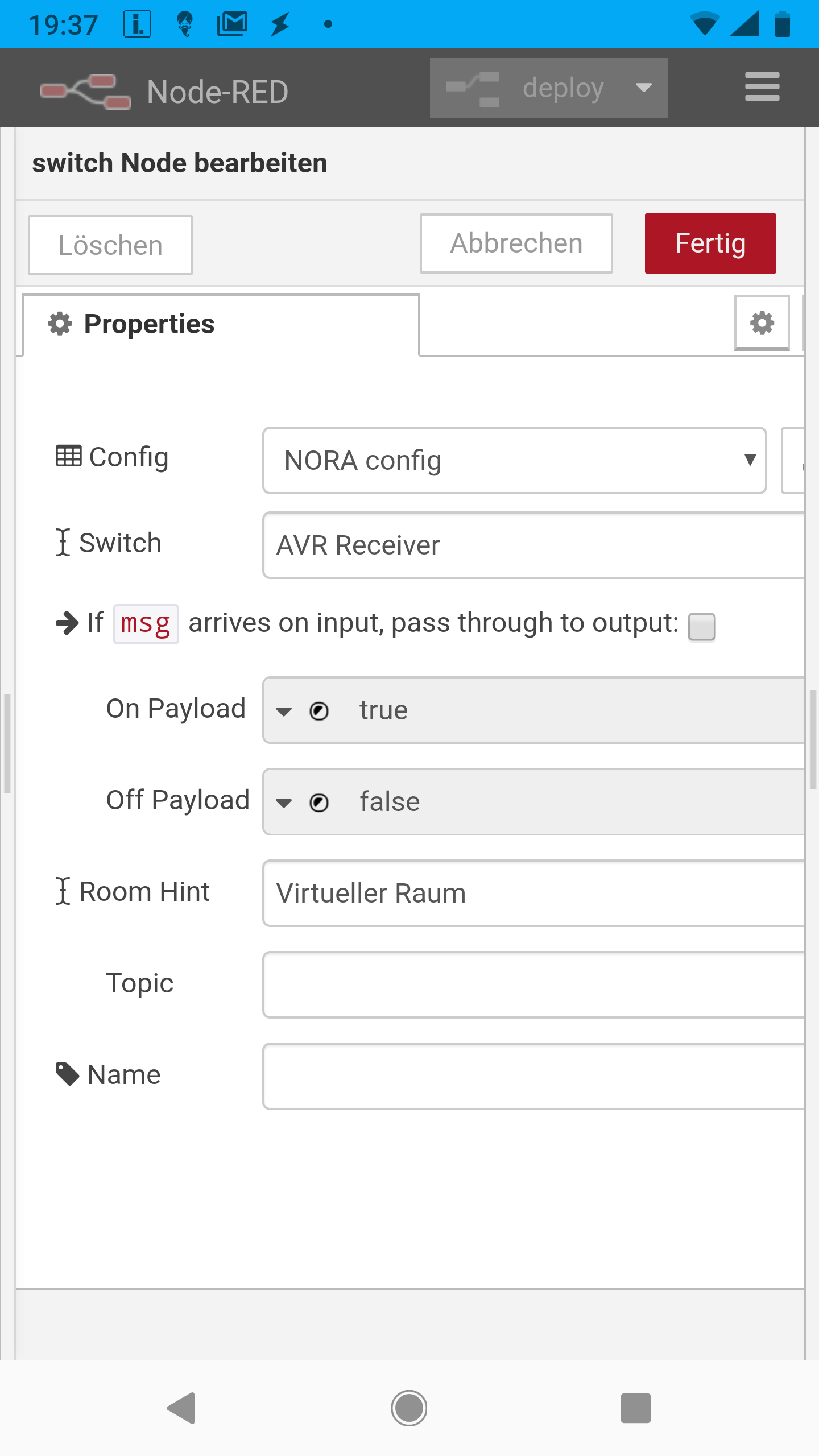

Hello, that should actually be possible. I have in NodeRED the “nora” addon. Here you can turn lights, switches, etc. in with HA control. You can also add “Nora” to the Google Assistant. in the Google Home app, the switches or lights that you created in NodeRED with “nora” are displayed. Now you can easily add them to the “routine” in the Google Assistant and turn them on and off.
Here some Screenshots:
“Nora” addon in NodeRED

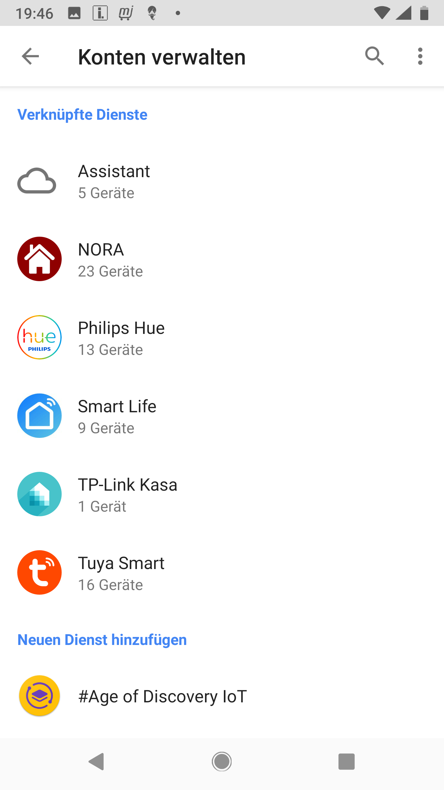

“Nora” in the Google Home App

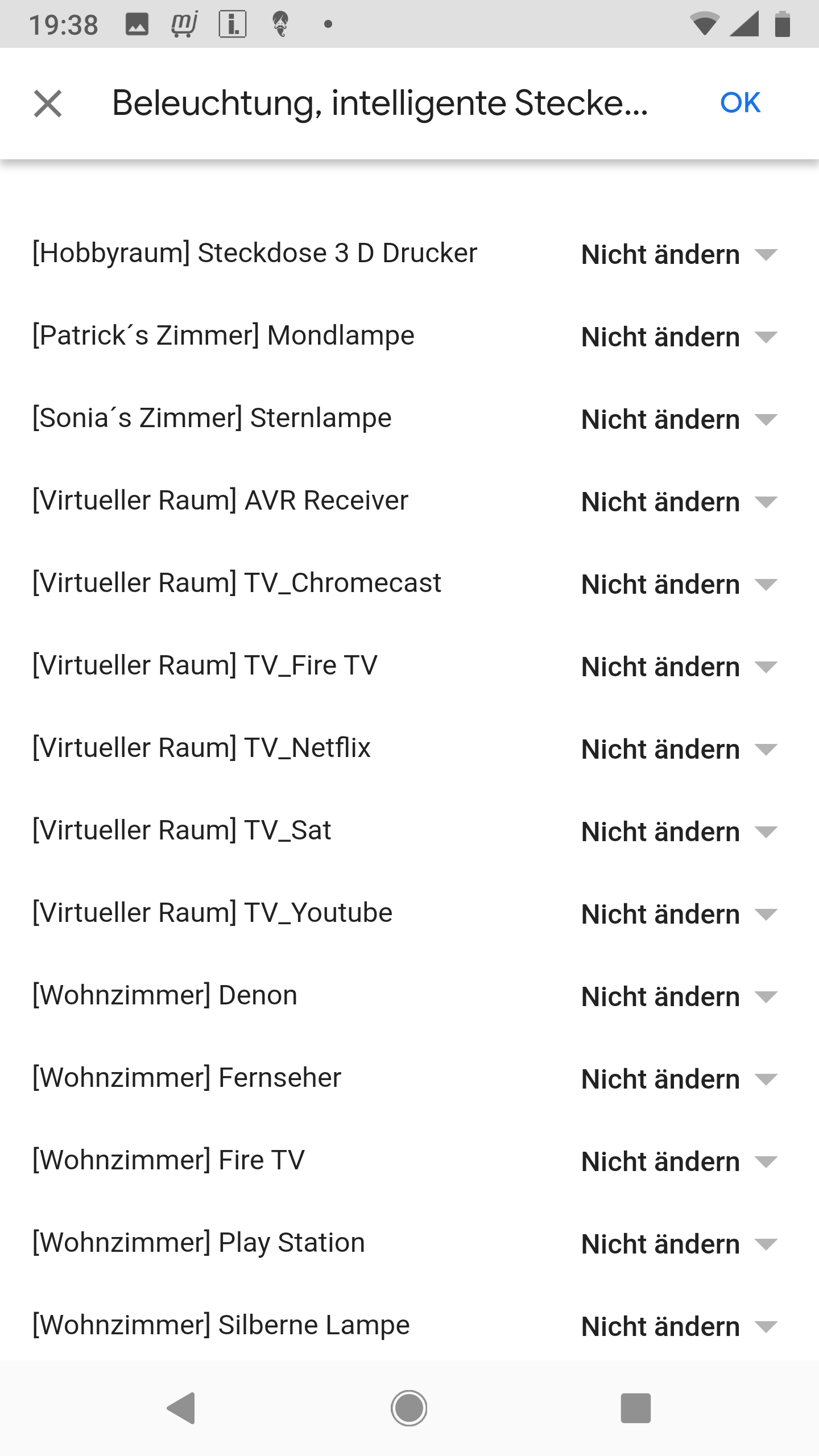

Screenshot from “routines”
