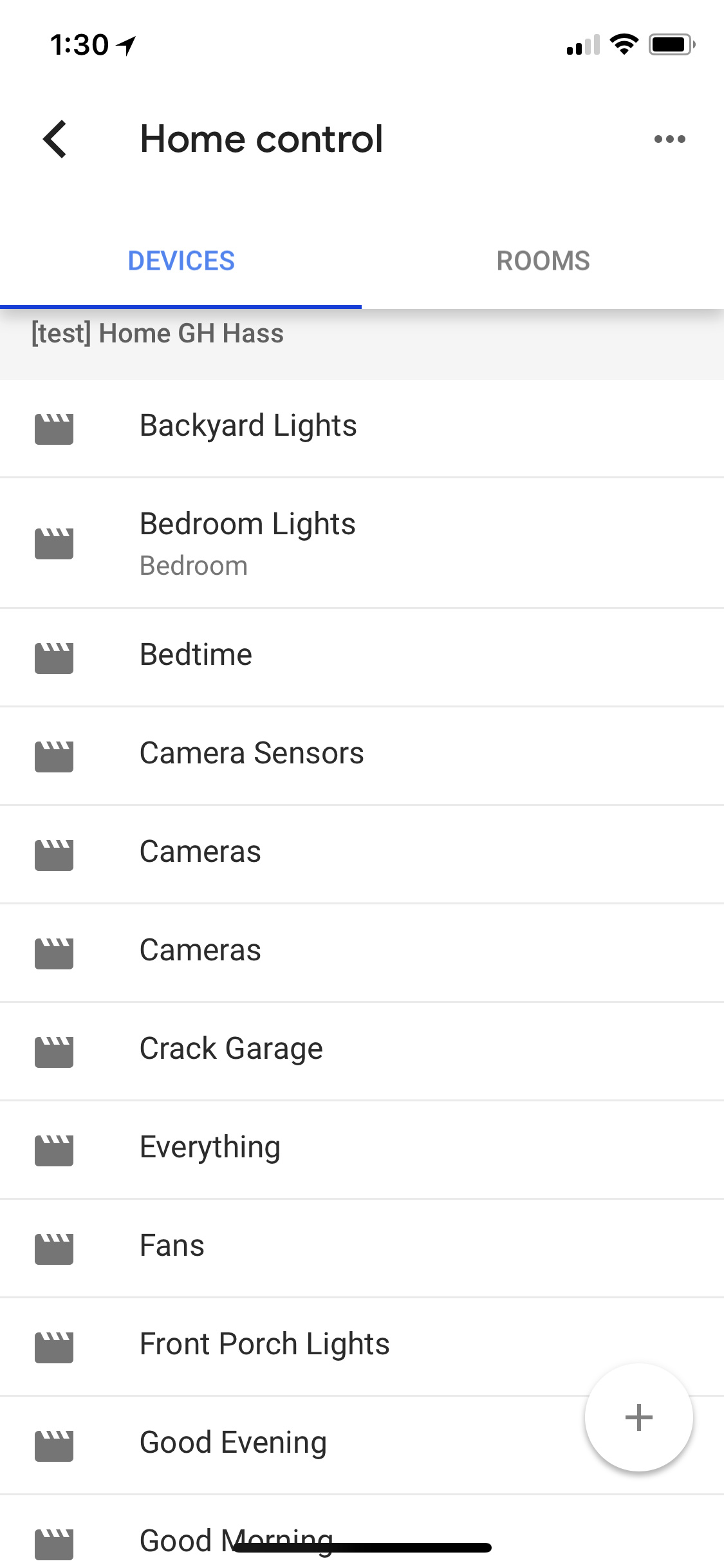

I just bought a couple google home minis and am trying to integrate… I unfortunately found out that the emulated hue support no longer exists (so I can’t just reuse my Alexa support) so I went through the steps of configuration. Everything seems to be correct in that I can see all of the exposed items in my GH app (screen shots attached), but telling it to turn on / turn off stuff doesn’t work. Am I missing something? Here is my configuration:

And the screen shots of my items in my GH app:
Am I missing something? All looks good in my gcp dev console. there are no errors validating and the google app pulls all my HA data so I assume no connectivity problems…
BTW, running .58.1 on rpi3.
I think groups are still treated as scenes. Can you try “activate kitchen lights” or “start kitchen lights”?
Just tried that (makes sense since the icons all look like scenes). She comes back with (verbatim) “I’m sorry, there was an error and I am unable to control your home device”.
