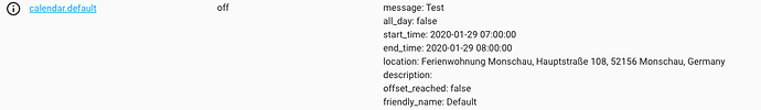

Take a screenshot of the attributes inside devtools/states page of the calendar entity.
Hmm, no idea. Maybe the card accesses the calendar itself. There are no attributes in there that would point to the missing data.
The card uses the calendar.default information to show 5 entries. The card requests 7 but gets the default 5 from the optional max_entries setting. Makes me think it’s hiding somewhere.
it would be on the entity itself. Whats the entity_id that you use?
I’ve only used the calendar.default everywhere, including the lovelace card.
