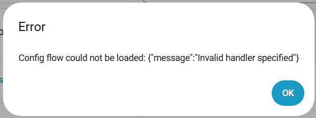

When I try to reconfigure the integration, I get a simple pop-up with:
“Config flow could not be loaded: {“message”:“Invalid handler specified”}”
