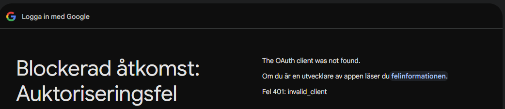

Google calender Blocked access
I keep getting stuck with this. Is there a way to resett since I apparently have filled in something wrong.
Realy? Nobody has ever had this issue? Is the coding realy so bad that it needs a complete reinstall of HA just to get out of a connection error?
Have you tried deleting the credentials from Settings → Devices and Services → three dots top right?
Thank you. That solved the issue :slight_smile:
