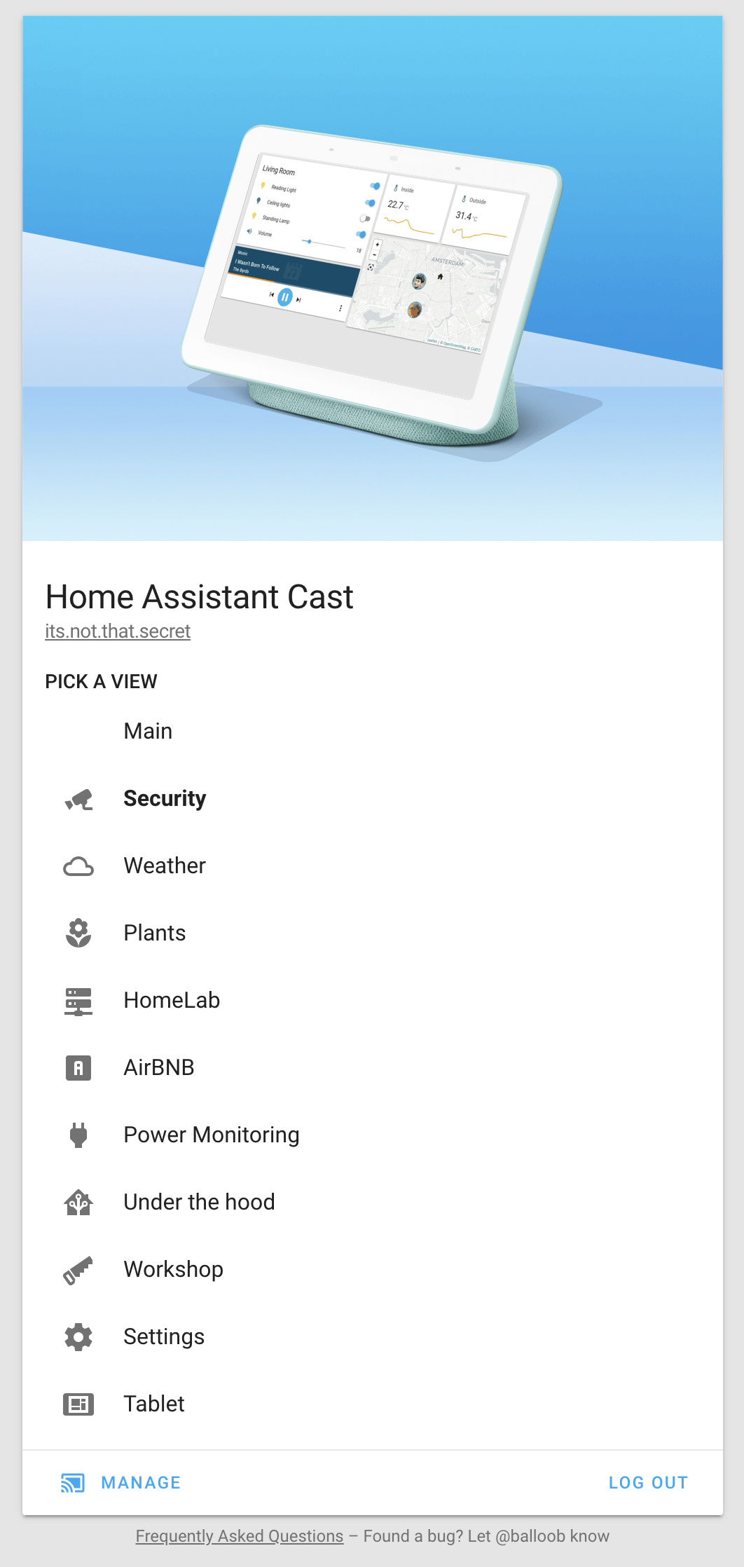

  1. logout from https://cast.home-assistant.io
  2. Stop the mediaplayer with the media_player.turn_off service
  3. Then start de cast with the service

Question: I have never signed into https://cast.home-assistant.io but was able to get a few of my views to show up on my Google Hub via cast. Is signing in a necessary step?

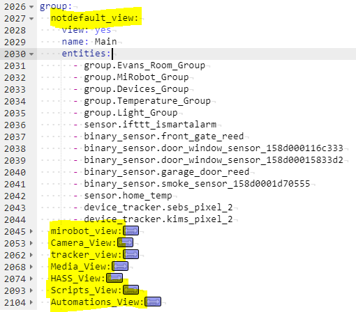

If it helps anybody, the ā€œcast.show_lovelace_viewā€ seems to be able to recognise the names of all my ā€œgroupā€ (non-lovelace) view names as shown below (from the configuration.yaml file).
The service should be called ā€œcast.show_states_viewā€!!!
