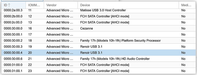

in proxmox i selected this pci device
Which passes thorough the whole usb controller

Its still the usb coral but passthrough the usb pci device.
ie pass he whole pci device through that the usb coral is plugged into.
