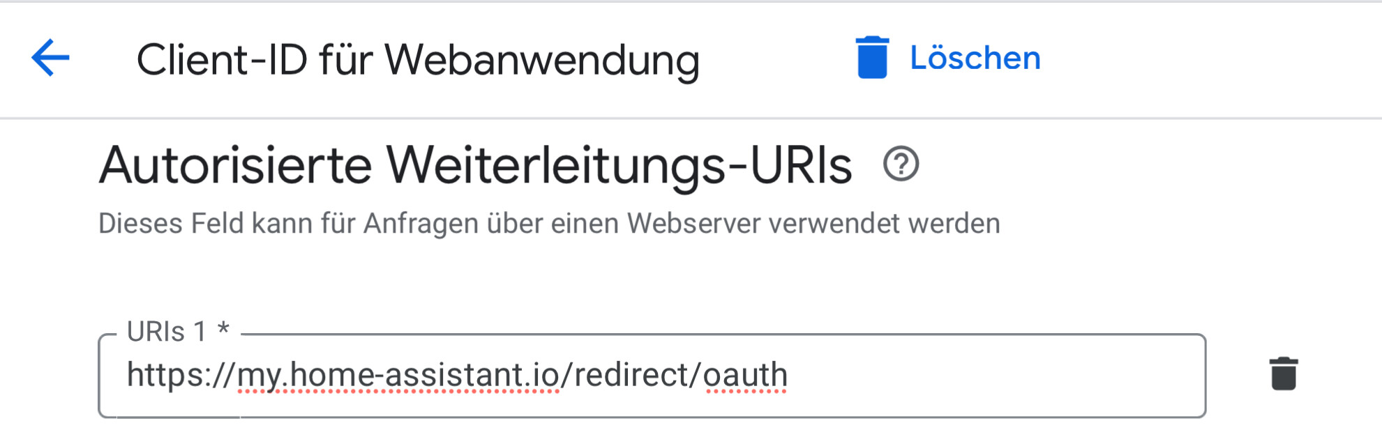

Thanks a lot for getting back to me and for your help!
I think I actually have entered the address you provided:
As I had the impression some redirecting is the problem, I tried with different browsers. Chrome and Firefox on my desktop, then also via the app and Safari. But as mentioned without success, unfortunately.
