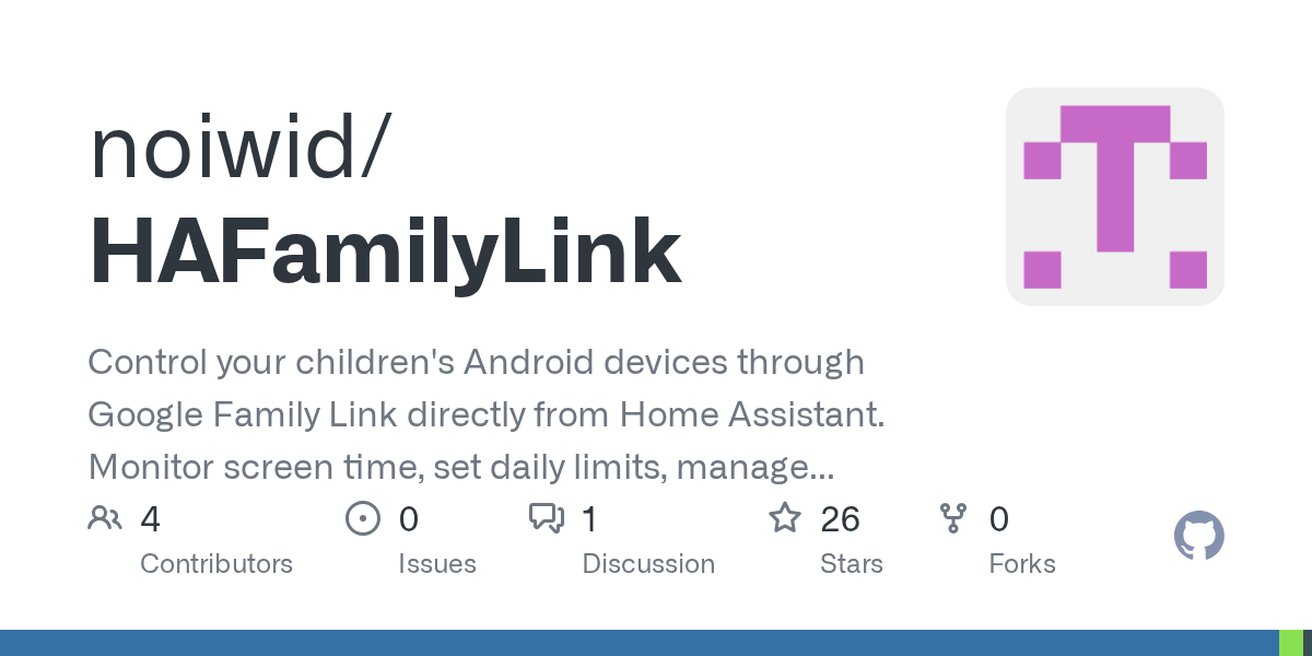

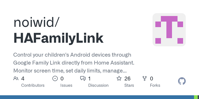

Not my project but I came across this:
Could be “vibe coded” based on the documentation. Needs a separate docker for Google authentication if you’re running HA in a docker.
