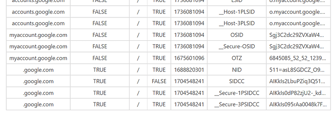

The cookie file (changed some parts) look somehow like this:
# Netscape HTTP Cookie File
.google.com TRUE / TRUE 1688543600 AEC AakniGNEHPLpmjhfnQneMldbcvea_ml6Phu_twx2Bwösafdjsfjfsjlasf0
.google.com TRUE / TRUE 1736333600 CONSENT PENDING+646
consent.google.com FALSE / TRUE 1675597631 OTZ 6845027_52_52_166600_48_466680
.google.com TRUE / TRUE 1733333634 SOCS CAISNQgEEitib3FfaWRlbnksfahökfsajjlkfasdjklasfhfasölA3X3AxGgJkZSACGgYIgMndnQY
.google.com TRUE / TRUE 1633360340 NID
