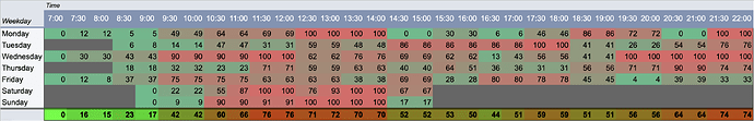

Thanks to this I was able to build a heatmap for my local gym:
Minor issue I’m facing now is that the component seems to update not frequently enough to differentiate the 30 mins slots.
Is there any way to increase the update frequency?

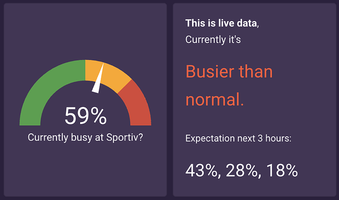

Are you willing to share the .ymal of you’re top setup? I would like to integrated it into my dash.
Sure, here you go:
type: vertical-stack
cards:
  - type: horizontal-stack
    cards:
      - type: gauge
        entity: sensor.healthclub_sportiv
        max: 100
        severity:
          green: 0
          yellow: 50
          red: 75
        needle: true
        name: Currently busy at Sportiv?
      - type: markdown
        content: >
          {% set array = state_attr('sensor.healthclub_sportiv', 'popularity_' ~
          now().strftime('%A').lower()) %} {% set popular_now =
          states('sensor.healthclub_sportiv') | int(default=0) %}
          {% if array and array is iterable and array | count > now().hour %}
            {% set array_copy = array[:]|list %}
            {% set historical_now = array_copy[now().hour - 1] if now().hour > 0 else array_copy[0] %}
            {% set deviation = ((popular_now - historical_now) / historical_now * 100) | abs if historical_now > 0 else 0 %}
          {% else %}
            {% set historical_now = 0 %}
            {% set deviation = 0 %}
          {% endif %}
          {% if state_attr('sensor.healthclub_sportiv', 'popularity_is_live') ==
          true %} **This is live data**,
          {% else %} **This is NOT live data**,
          {% endif %} Currently it's
          {% if deviation < 5 %}
            <font size="5"><font color="#2ea1cc">Normal.</font></font>
          {% elif popular_now < historical_now %}
            <font size="5"><font color="#59b82c">Less busy than normal.</font></font>
          {% else %}
            <font size="5"><font color="#ff5733">Busier than normal.</font></font>
          {% endif %} <br> <font size="2"><font color="#ffffff">Expectation next
          3 hours:</font></font>
          {% if array and now().hour + 2 < array | count %}
            <font size="5">{{ array_copy[now().hour] }}%, {{ array_copy[now().hour + 1] }}%, {{ array_copy[now().hour + 2] }}%</font>
          {% else %}
            <font size="5">Data unavailable for future hours.</font>
          {% endif %}
    card_mod:
      style: |
        ha-card {
        border-radius: 15px;
        box-shadow: 3px 3px 10px rgba(0, 0, 0, 0.2);
        padding: 12px;
visibility:
  - condition: state
    state_not: "0"
grid_options:
  columns: 12
  rows: 5
