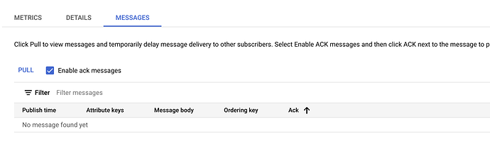

For some reason in the pub sub console I do not see any messages:
But metrics look healthy:
Any suggestions on what I may try next to debug this?
