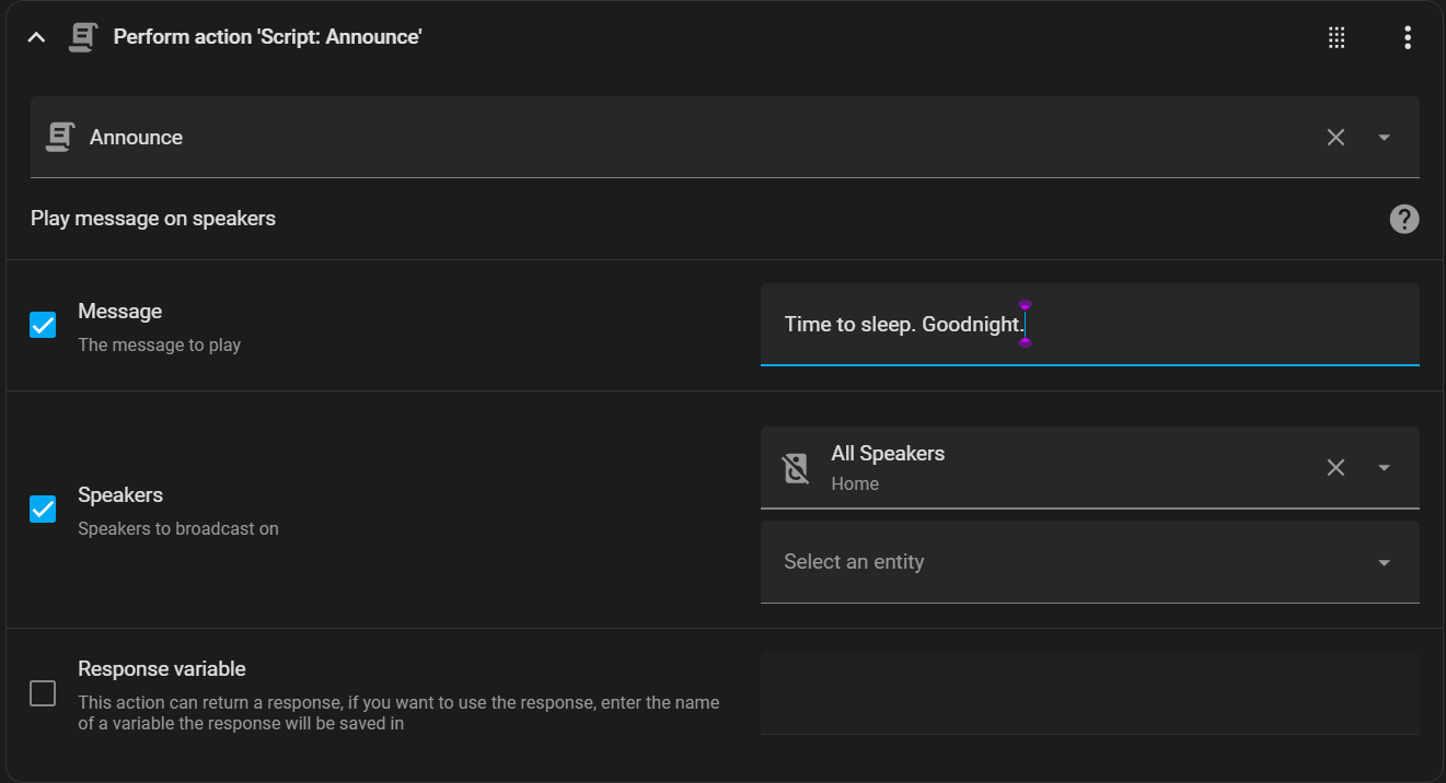

I have changed my announce action to be like this:

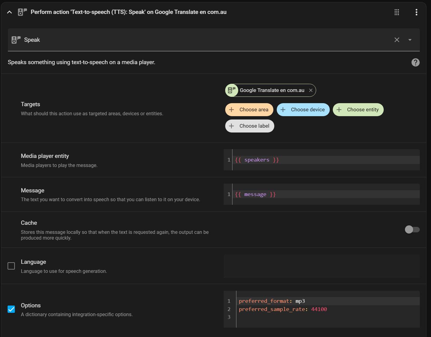

  • action: tts.speak
    entity_id: tts.google_translate_en_com_au
    media_player_entity_id: “{{ speakers }}”
    message: “{{ message }}”
    cache: true
    options:
    preferred_format: mp3
    preferred_sample_rate: 44100

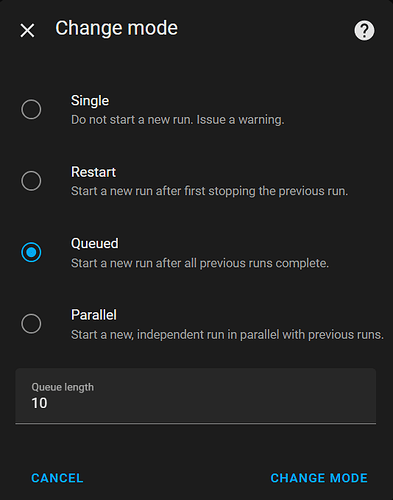

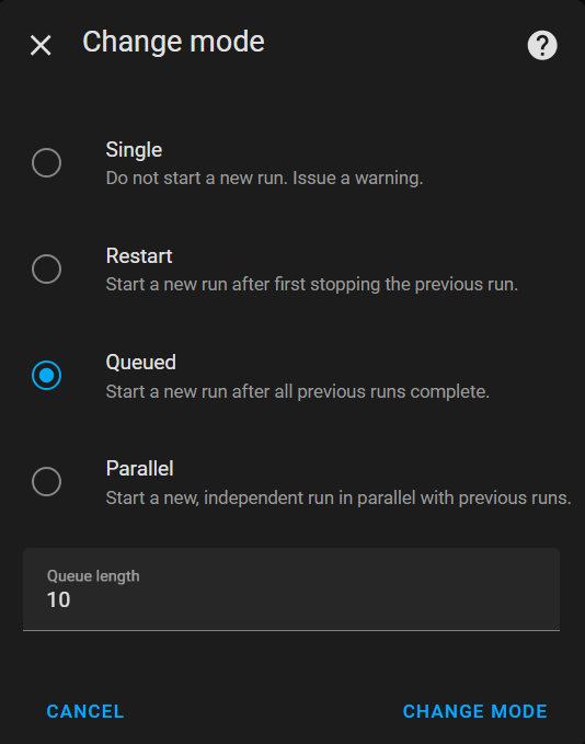

    mode: queued
    icon: mdi:bullhorn-variant
    max: 10

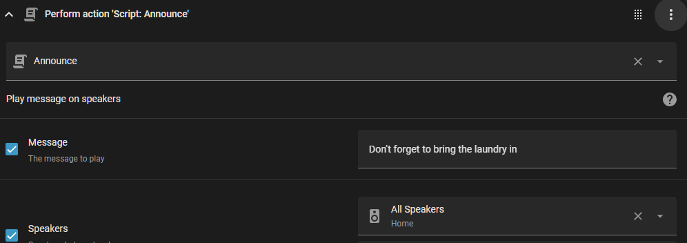

Today an automation played the message “Don’t forget to bring the laundry in”
What I heard was “Dep” … pause …“Dep”
Come on this is ridiculous there’s nothing else playing There is a 10 second pause which is more than twice as long as it’s needed.
I went back to the action and ran the announce and it is fine.
And then I typed this out (5min) and then I ran the action again
This time it said “Don’t forget to brpp” … pause …“Dep”
It is literally cached and proven to have worked just a few minutes ago.
